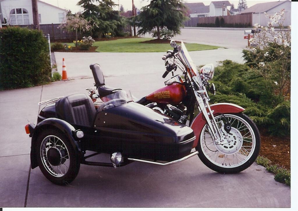

I went another route with my '87 FXLR. After a $9,500. T-bone wreck I rebuilt it as a Springer.
Shown here with 2 different hacks.
