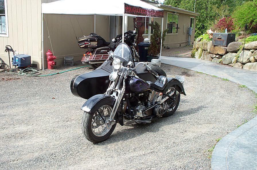

Ok, new guy here. just added a stock 47 sidecar to my 46 knuckle.
Bike is stock frame but have late model springer. I think they are 2 inches longer than original springer. At about 15 up to 25 I need to hold on tight or it really shimmies. I am going to start with some new neck bearings right now but thought I would throw this out there and see what kind of wisdom might pop up. This springer does not have a dampner like the original does. I have also thought about changing front tire to a flatter style rather than the rounded newer tires. I am in WA state. thanks, ric

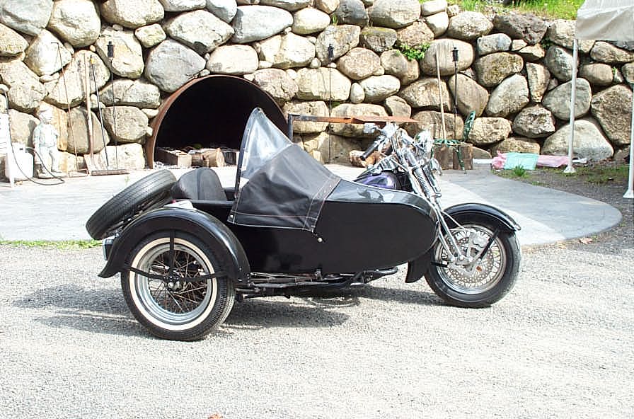

Hi Chuck, thanksfor the tips. I was told the other day that the late model springers had an inherint problem with the bearing and seeing how mine are kinda lose already I quess I better get straight to it. I was also told I might find adjustable neck race's. If I kick it out more does that also help?
I added a couple more shots too. thanks

Is that a L&W windshield? I had one for my sidecar
