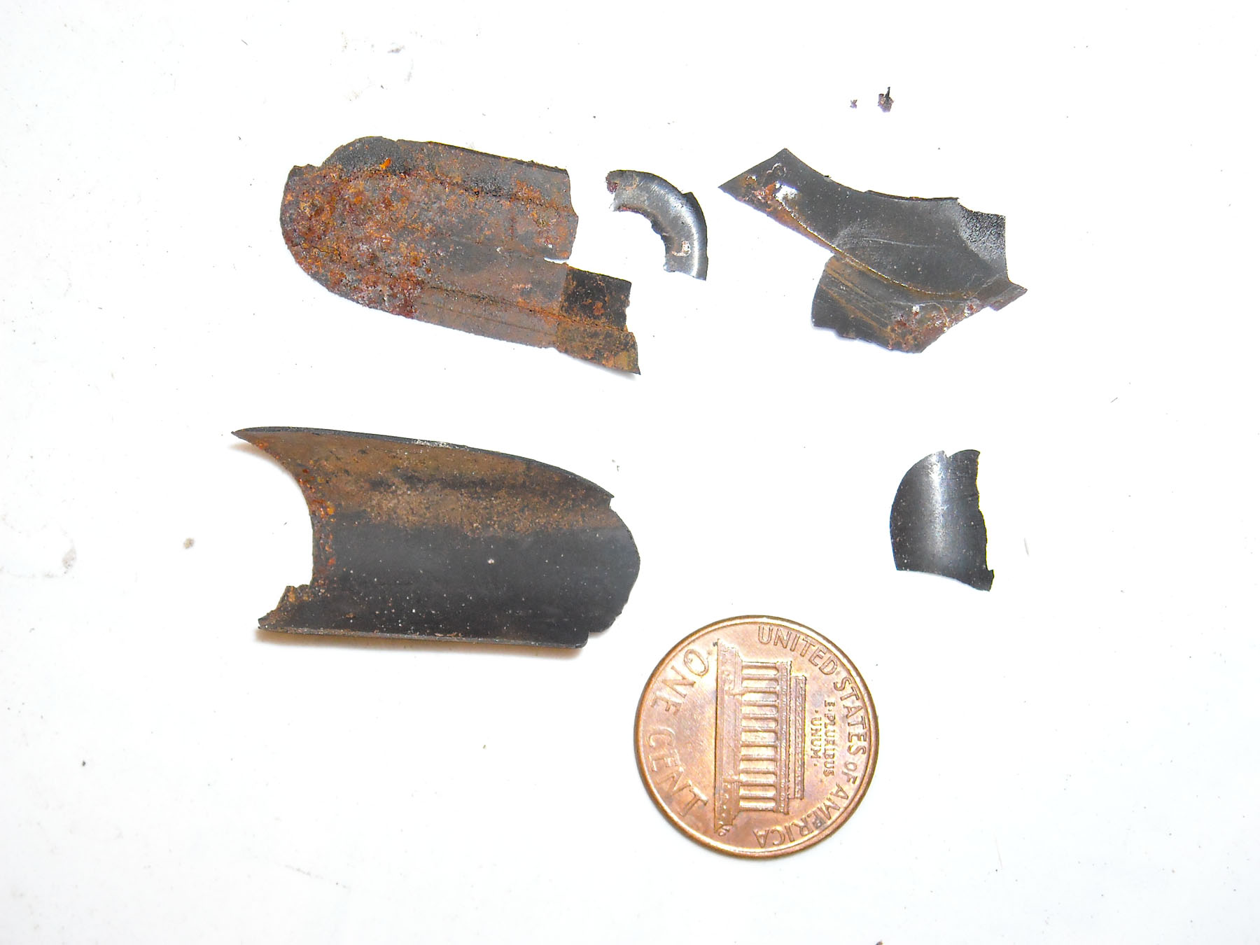

Picture enclosed of about 50% of the Plastic coating that fell off-more would have come off if I had scratched further- But as I leave for Blighty in a few days time I was more interested in halting it until I get back and changing the engine oil as that had gone a dark brown colour.
Will have to investigate the stainless kit suppliers you mention when I get back to UK.
All the tires are getting near to the time they need replacing- is there anyone over here who supply wheels that take car tires?
Thanks for the info.
Paul

Its interesting that Harleys plastic coating didn't last a year and rust did become an issue.

Obviously, as you are no doubt well aware, it's a matter of humidity and salt air. I'm not sticking up for the company since they do have some problems wth regard to corrosion. On the other hand, it has a lot to do with the atmosphere where you are.
I saw your former pictures of that upper front mount and that sort of thing just doesn't happen in California, especially inland. I've seen spokes and hubs corroding on machines that are on the coast to a lesser extent than you have, however.
I also know that HD just won't warranty damage that occurs as a result of adverse ambient conditions. For example, I had a package rack on the rear fender of my 1993 FLHS. After a year, the plating turned dark yellow where the chrome was thin. The nickel was showing through. It looked like h**l. Since it was out of warranty, which used to be 12,000 miles or one year, the dealer told me politely to pound sand. That gave me a warm feeling since it began corroding soon after I got the bike and I just never got around to complaining until it was too late.
I've seen lots of Harleys, and some Japanese bikes too, that had less than stellar plating.
I agree with you though. I'd be incensed. However, even if you got another new sidecar, where you are located, I think you'd have the same problem.
I wonder if any other manufacturers will cover that sort of damage after a while.

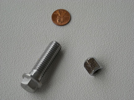

So I have bitten the bullet and have spent $300 so far on Stainless bolts to get away from the rust bug.
It's interesting I have a 1999 Chevy Van and that's not rusting anywhere like the Harley.
I am glad I took notice of the Harley Rep and used S100 on the Chrome- they even sell it in the Harley dealerships,the chrome is still perfect.
Pic of the acorn nut that holds the horn on- again replaced with Stainless.
Interestingly when I replaced one of the Cam Cover bolts- it had oil on the bottom of it.

Enjoy the ride, don't sweat the little stuff, You're in a salty, humid area. Salt + humidity = oxidation. You have a lot of outsourced chrome plated stuff on that bike. Thanks to the EPA US chrome plating is not nearly as protective as when it was a complete three step plating process 40 years ago.
