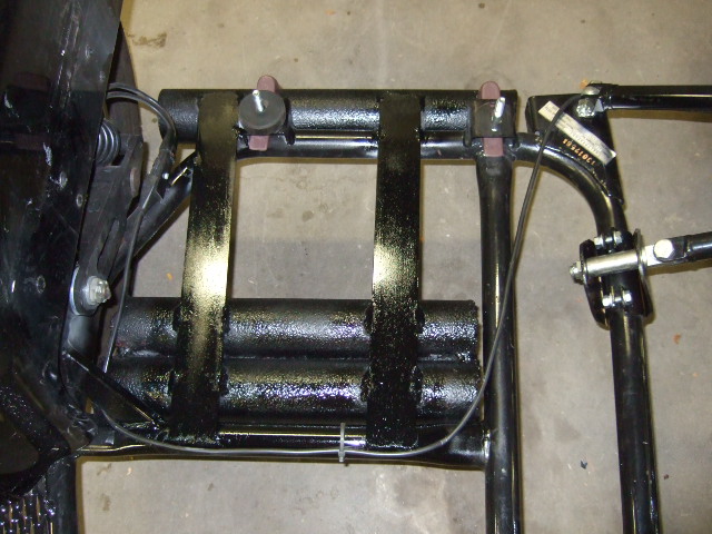

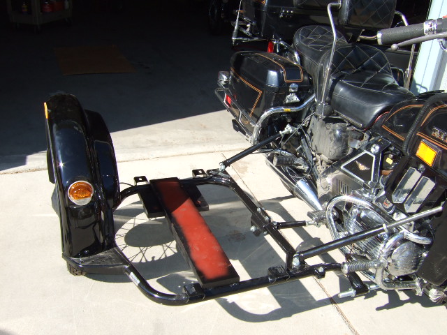

The 563T weighs 170#. If using soft ballast (won't damage the body if it shifts) place it behind the seat in the trunk. Steel stock if used, works best mounted below the body, placed at the rear of the the frame and to the outside if possible.
Here are two examples of permenant ballast: A 563T using 3" steel rod stock for ballast and a 562C using 1"x5" steel plate.
