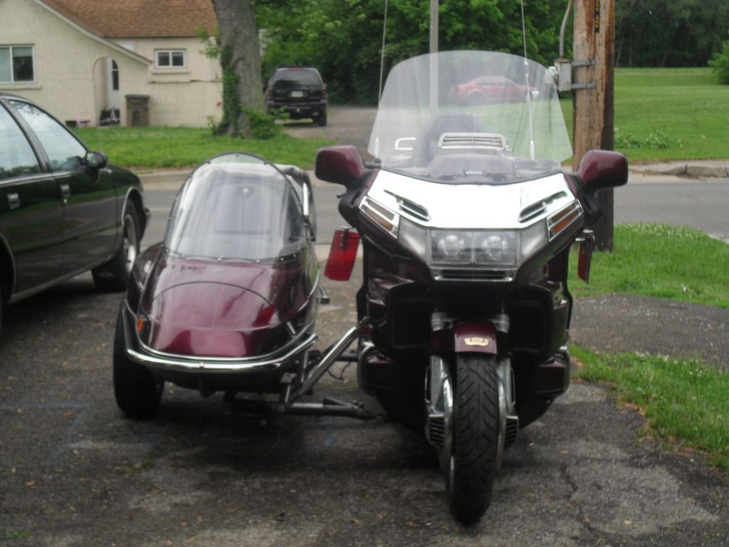

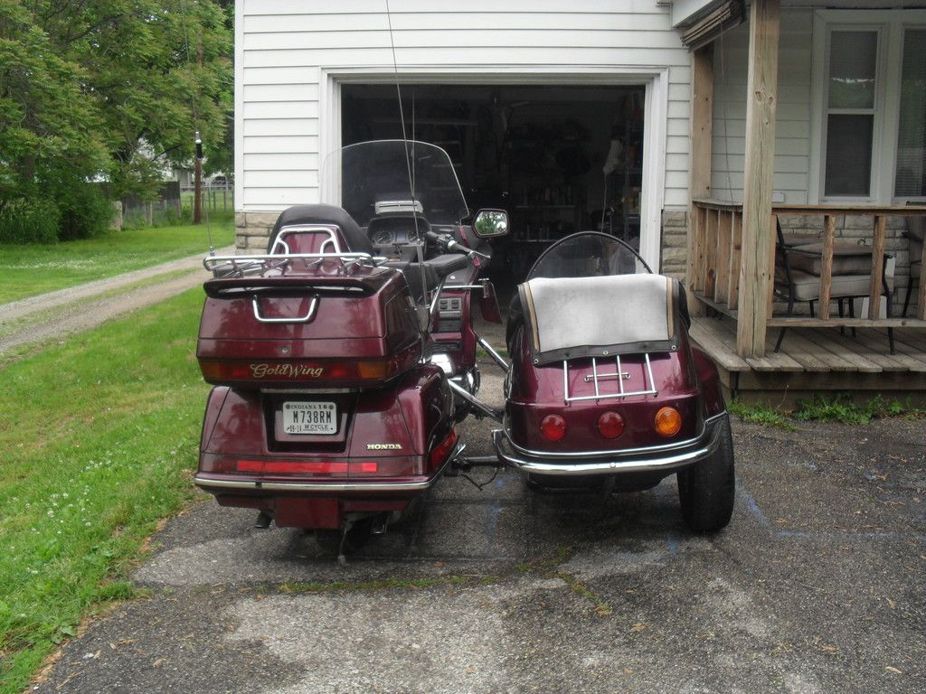

Thanks for the replies...I had a little bit of spare time yesterday to tinker around, and got the issue improved, but not completely resolved....here are some pics...the first is how the bike currently sits.
And the rear view...

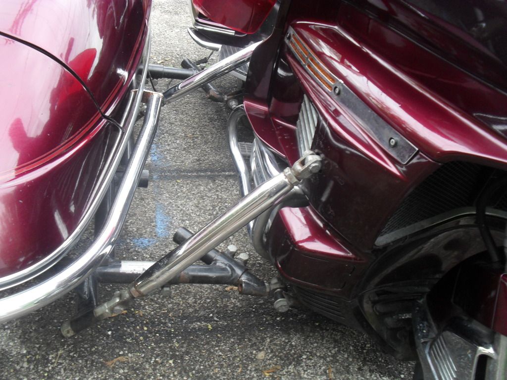

I figured out how to adjust the angles, but still need to do a bit more. I did get it to the point where it's actually able to be ridden. The pull is gone with the exception of a slight left pull when breaking. The sidecar tire went from maybe having 1/3 making ground contact to 2/3...I know that's still not right, but it's a definite step in the right direction. Here is a pic of the adjustment bars. It's an older model, and there is no electric adjustment...all wrenches, sockets, and a deadblow hammer.

I tried the link, didn't work. I will attempt to do more tweaking on this to level it out, but I'm about at the point where the bike will no longer be level if I go much further. It rides decent now, but it's not perfect. I did put a level on the sidecar, and it was about 3/4" from actually being level....the pic makes it look much worse.

As Jay said you need to start ALL over. A little tweaking of attachments is not going to do it and you'll continue to chase your tail. You have to completely disconnect the sidecar, all four connections. Raise sidecar on a MC jack or stand until level, move bike along side be sure it's vertical and then adjust sidecar components so that sidecar remains level and bike vertical. After it is attached load your sidecar with approximate load weight you expect to carry then you can make adjustments for toe-in and lean-out. I heard you mention a dead blow hammer, if you have to resort to that to align attachments you are torqueing the attachments and frame putting everything under tension. Attachments usually have more than enough adjustability and should go together easier than that. I don't know anyone who has gotten their sidecar aligned properly the first three attempts, keep at it and you'll get it.
