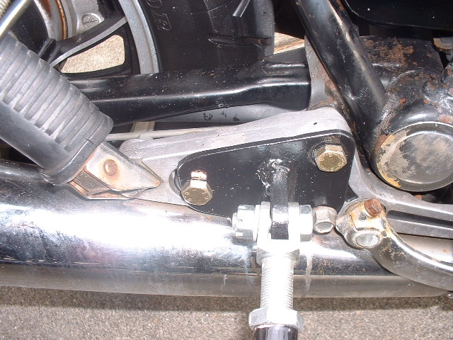

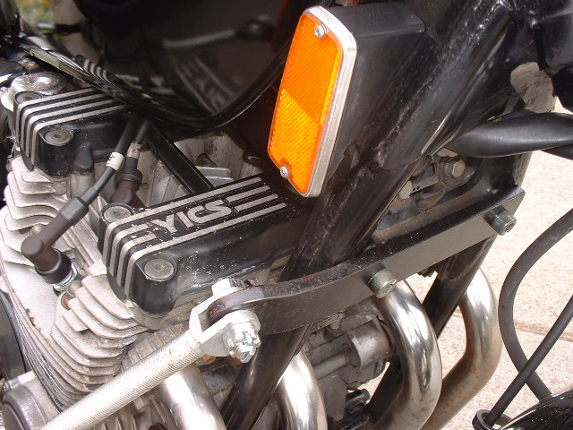

We've done dozens of 650 XJ/562 conversions and they work great using part of the OEM mounting kit and 2 design parts.
The XJ650 is a bit small for all around 3 up usage in my opinion. An 1100cc model would be a better choice.
Attached are pix of the special mounts I use.

I built an 1981 XJ650/Velorex rig a couple of years ago. I used special brackets similar to those described by Lonnie (he sent me pictures that I used as templates) In addition, I made a bracket out of 1/2 inch steel plate that I hung from the rear shock for the rear upper mount.
In addition to mounts, you might consider heavy duty shocks and fork springs. I also added a steering damper and Avon tires (triple duty sidecar tire on the front). The result is a great handling and riding rig. I agree that a 650 is a little small for extended freeway use, but for state routes and back country riding it is fine.

Sorry Mike,
We are not a manufacturer. I build on the bike. Any fabricator or weld shop can duplicate these mounts.
Our HD suspension upgrade to allow early 15mm axle Velorex's to support larger bikes, heavy loading or off road use is the only prefabbed kit we offer.
