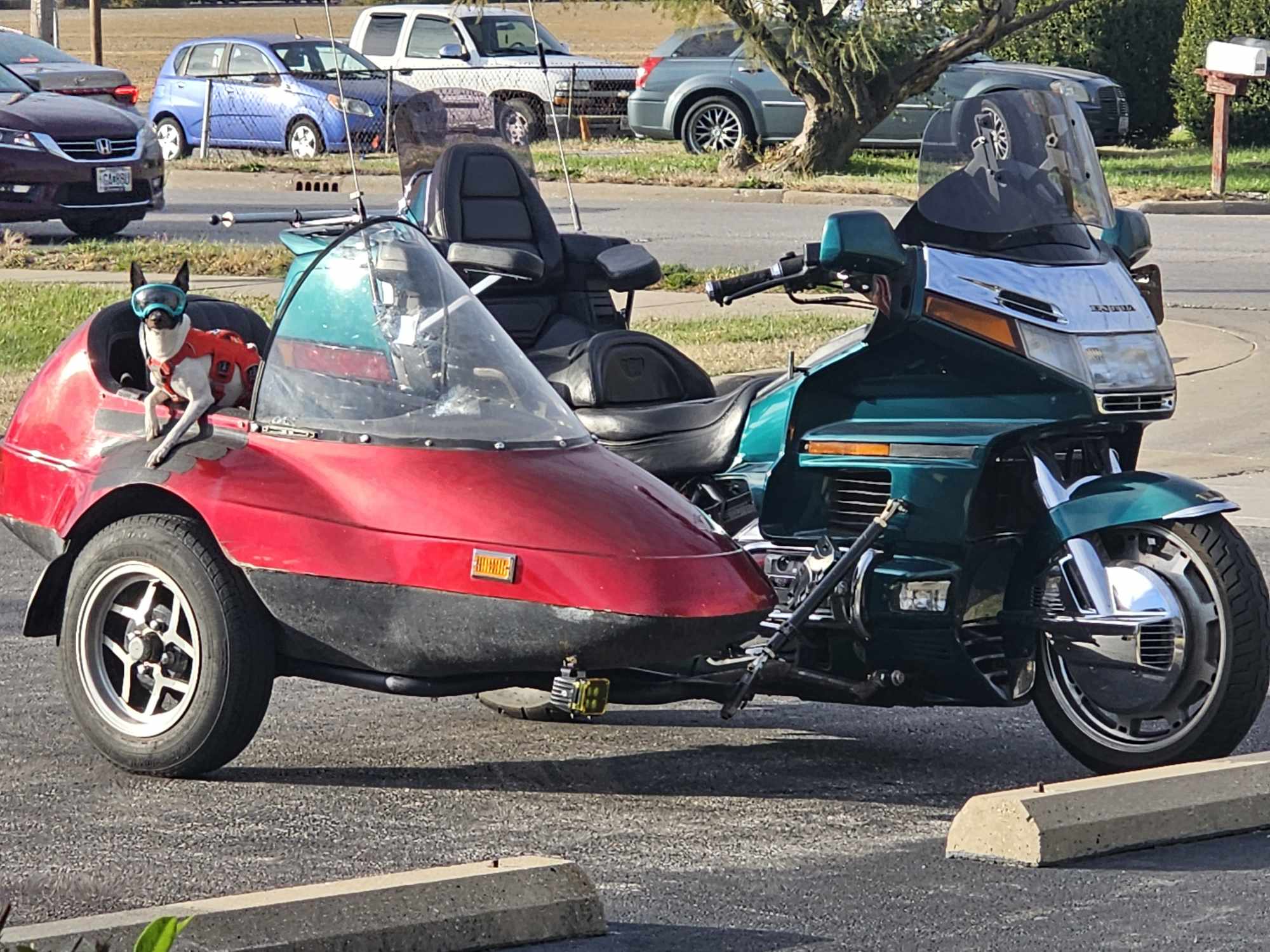

And what do you mean, Mr. Miles,  paint the sidecar?  I was just going to put some green pin stripe on it and red pin strip on the bike. It'll match,,,lol. Just kidding of course,,, maybe??  I actually did run into a guy who said he could paint the sidecar for me for $100 plus material. I'm sure I would end up with a $100 paint job. But it would hopefully look better than it does now. I know it looks bad, but first things first.
I would love to get a convertible top for the sidecar. Any temps above 85* and poor Wilton doesn't like the sun. He hides in the nose of the car. But I did rig a pillowcase across the dash to keep the sun off him. You guys have any idea if I could have a top made and the cost? I might consider doing a top before the triple tree. Cause if my boy dog aint with me I just don't hardly ever go. I actually missed a lot of riding because it was too hot for HIM.

Cal, oh Cal.....your sidecar rig  does  NOT  look bad, because the  bike  and the  sidecar are  different  colors. Don't  be  a Scrooge.....your bike and  sidecar  look like a  Christmas  rig.
As for a sun protection  roof for  keeping  Wilton from wilting.....I  would have a vinyl  tonneau cover made that snaps on.....secured by snaps around the  upper  curve of the  windshield,  and across the  upper  back of the  fiberglass  body of the sidecar. Installed it should be  stretched  tight  enough to  not flap in the  wind. Can be  removed  in 18 seconds, or Installed in  24 seconds,  and the entire  tonneau  cover  and installed  snaps  should  cost you  about  $ 100.00, all done, all in.

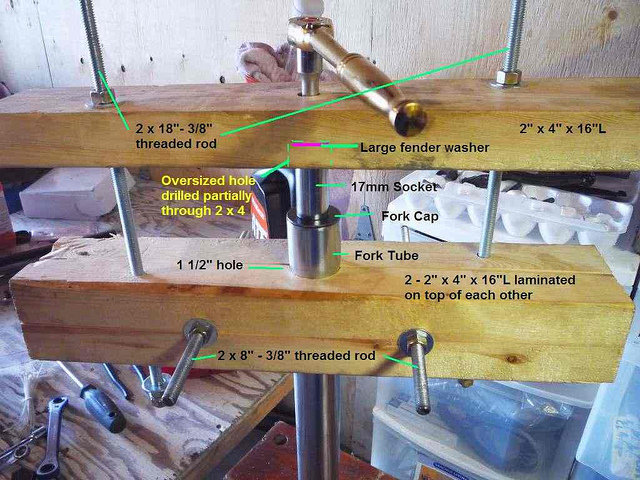

Fork rebuild.
I've rebuilt several sets of forks. Two sets for a 1200 Goldwing, and a few on my Japanese bikes. I know the 1500's can be a bear with the longer progressive springs and you really need a proper tool for safety. I really don't know what's in there now. They could come shooting out and take my head off.
So. I need to come up with said tool. The Honda tool is crazy money, just like the steering bearing tool.  (Next in que) So I'm going to build a tool like I have done for many other projects. Question is, which version. It looks like the easiest might be the one with wooden blocks and all thread rods. Just wondering what you guys have done? Any one build this one?
