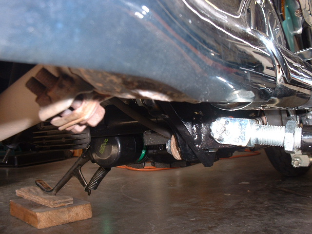

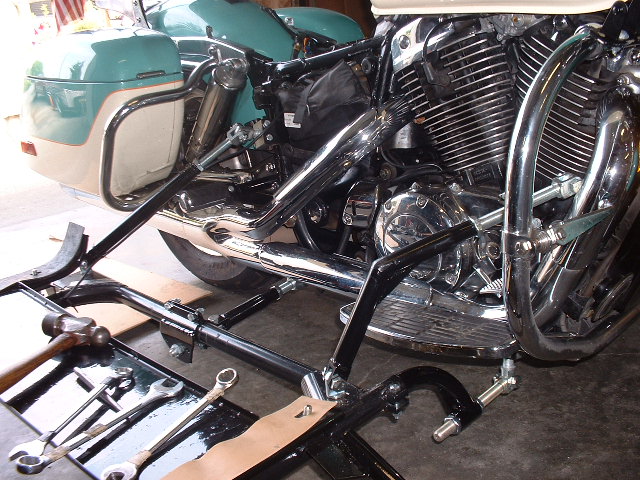

Here are a couple.
Sometimes you may have to shave a U-clamp strap a bit or fabricate a small mount bracket or two or maybe bend a strut. There is no such thing as a one size fits all "Universal" mounting kit.

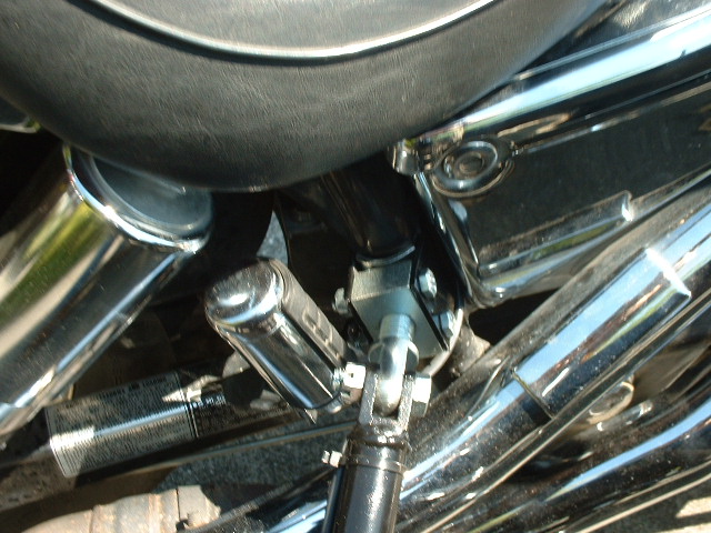

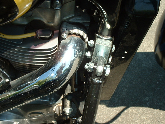

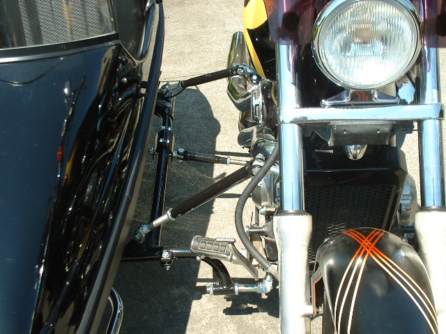

I have a Velorex on my 1100 link below will take you to my mounts.
https://www.sidecar.com/mbbs22/photos/photo-thumbnails.asp?albumid=210
Posted : May 8, 2010 10:57 am

thanks for the great pictures guys, Richard with having the upper mounts so low is there any top stability issues. And I did notice the brake pedal missing. I am thinking about going with a subframe so I dont do any damage to the bike frame, and it should give a more solid mount. Any more pictures and ideas will be greatly appreciated. Thanks again. Ps I probably should get the camera out for some before, during, and after pics 🙂
Posted : May 9, 2010 3:35 pm
Sub frames are always good. You can get your mounting points where you want them. I have had this set up for 5 or 6 years and no problems. Everyone is different so every rig is a bit deferent.
