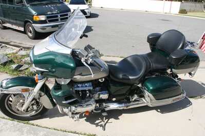

valkyrie green
daytona green
Daytona red
I believe I can attach pictures now.
Posted : July 22, 2025 2:04 am
Posts: 1047
One psychological point I would make: green is the hardest color to perceive in a vehicle.  For some reason, many people simply don’t recognize that a vehicle is present when said vehicle is green.
What year is the red 1500?  Has it had steering modifications?  In any case, both of those cars have the convertible top already included which makes it a lot easier for a human passenger to ride comfortably.  One challenge with the Daytona design is that the windscreen is flat and wind comes around the edges and smacks the passenger directly in the face without a top installed. DAMHIK.
Completely my perspective, but I would lean towards the 1500 Wing rig.  They have a cult like following and would be easier to “move along” than the Boulevard with the giant windscreen.
Posted : July 22, 2025 7:43 am
