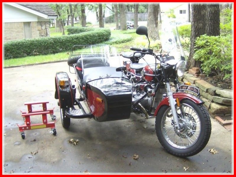

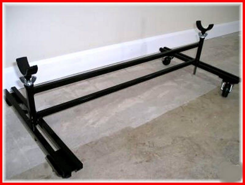

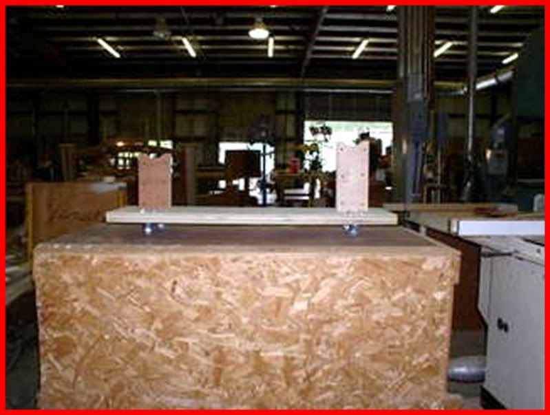

Several years ago, I built a sidecar dolly and matching sidecar skate to hold the frame and sidecar wheel when the sidecar is removed for some reason. I used 1-1/4" square tubing and 1/4" plate. I MIG welded it together. The threaded rods on the dolly are 5/8-11 thread and they can be set to hold the sidecar frame on the portion near the bike. The skate is put under the sidecar wheel using a jack.
Once the dolly and skate are under the sidecar, it's very easy to roll it out of the way for storage. All of the 2" rubber wheels swivel so that they can move in any direction.
My units are designed for a Harley sidecar but with some modification, they would work on any sidecar. Cost to build was no more than about $40 with the wheels and tubing.
Here are pictures.

Thanks for the notice. It's best to think in terms of two units: one for the inner portion of the sidecar frame and the other for the sidecar wheel. The "skate" unit that I have for the wheel would work on any brand of sidecar. The other part, the "cart" would fit most cars with some modification. All that's necessary is to make it low enough to roll under the hack when it's installed and yet be able to lift a bit beyond that level.

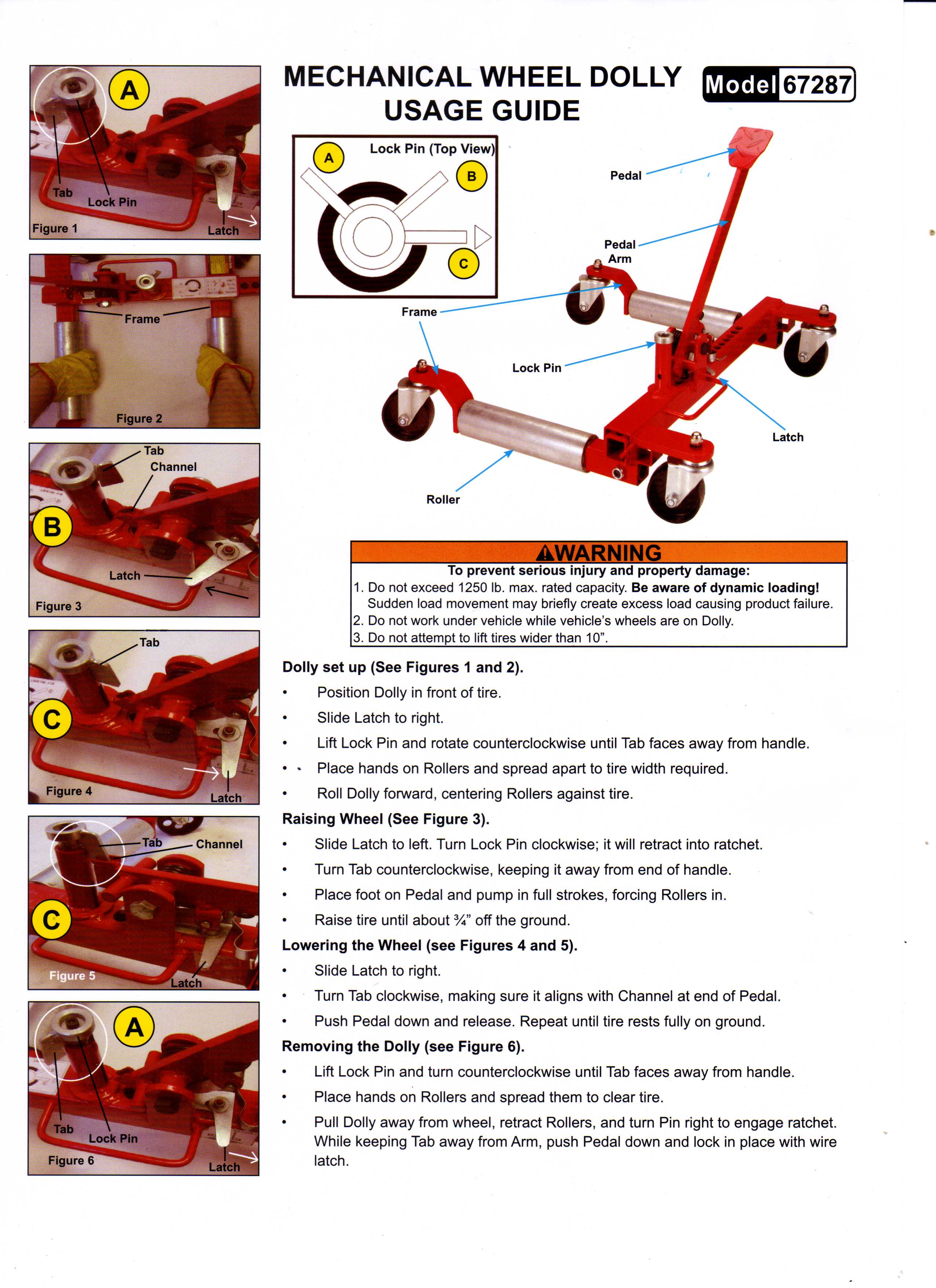

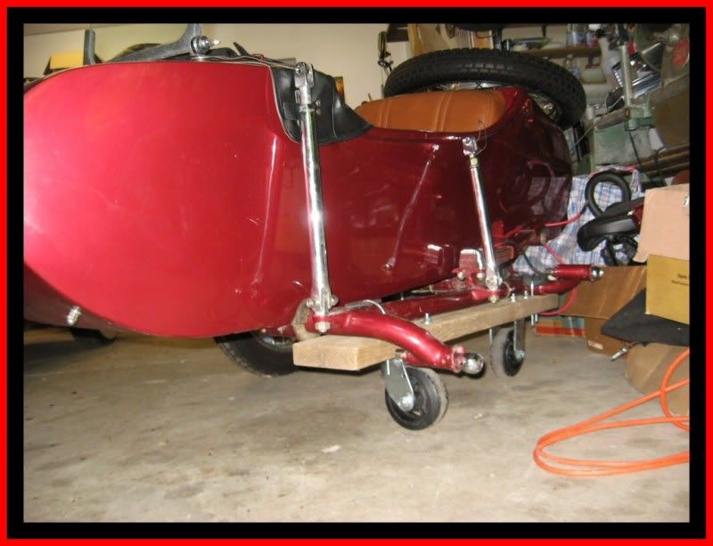

You will need a dolly that goes under the sidecar wheel, and another dolly that supports the inboard (bike) side of the sidecar. For the dolly that goes under the wheel, I bought a wheel dolly from Harbor Freight, U.S. General Model 67287. It is under $100 and works great. For the inboard side, I bought two 5" casters at Lowes and mounted them to a piece of 2x4. Many others have included photos in this thread of similar setups. Attached is the instruction sheet for the wheel dolly.
