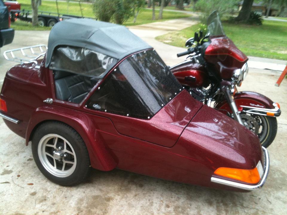

Finally got the brakes and the VW steering damper connected and test drove today. The wobble is very little now - mostly when I hit a bump.
Still pulls right on acceleration and left on deacceleration ---- pulls right when rear brake/car brake is applied -- pulls left if front brake is applied, does so -so if both are applied.
Still jerks left right on most shifts -- get a smooth shift sometimes.
Turns are now better but still heavy and takes both hands and no shifting in the turn.
Straight line driving is good-- can do it with one hand on bar but front will wobble if I hit a bump.
Right curves feel ok but on left curves the entire front seems to "float"
Is this stuff normal?
Will spending the $1500 to install a rake triple tree really help?
any advice is welcomed ---- thanks
Posted : February 19, 2012 6:44 pm

Wow, I have to tell you that seeing pics of this rig have totally inspired me to put a CSC FSIII hack on my 2006 EG Classic. I found one a couple of days ago, and brought it home today! Mine appears to be an earlier model (Mid 80's), but I just love the look of it on your bike. In fact, your color even looks like a close match to my Brandy Wine Sunglo. Great job you've done! Looks terrific!

Hey - thanks for the compliments -- we like it too. We went to the East Texas Spring Sidecar Muster this past weekend and really loved it --- This was our first trip and I finally got somewhat comforable driving the rig -- we drove almost 500 miles round trip.
When you get it installed, your bike will no longer be a bike --- it will pull to the right on accerlation, pull left on de-accerlation, steering will be heavy and may have head shakes at slow speed and you will wonder what the hell have I done -- BUT don't worry, a rake triple tree will care of most problems - don't bother with the steering damper - it was a waste of money for me. Just ride and be scared of the machine while learning - it will come to you --- do take the riding class -- I hope to take a class soon!!!
I got my TT from Libery sidecars and a local shop made the install along with some heavier springs in the front forks. Total cost was some $1500
I still need a little work on the Ultra --- first is to lower the gearing since Ultra gearing is tall - another is to add a reverse-- do I really need it? No -- but it looks uncool as hell pushing the rig. I turned greeeeeen with envy every time I saw a Ural back up.
If you need advice, just get on this site and ask for it ---- you will get many answers - none will be the same but they will be honest. Its really a great group here!!!
