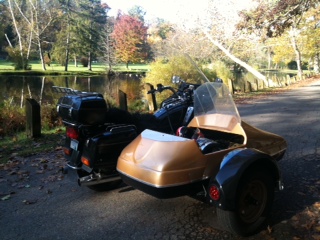

If your ride-by-side is the model I think it is, I may have the same car when Auburn made it. If so, then I may be able to provide you with some ideas on the car-side mounts. My mounts, both car-side and bike-side were purchased from Jay.
Here is a pic of my car, mounted on a GL1100 (1982 Goldwing)...
