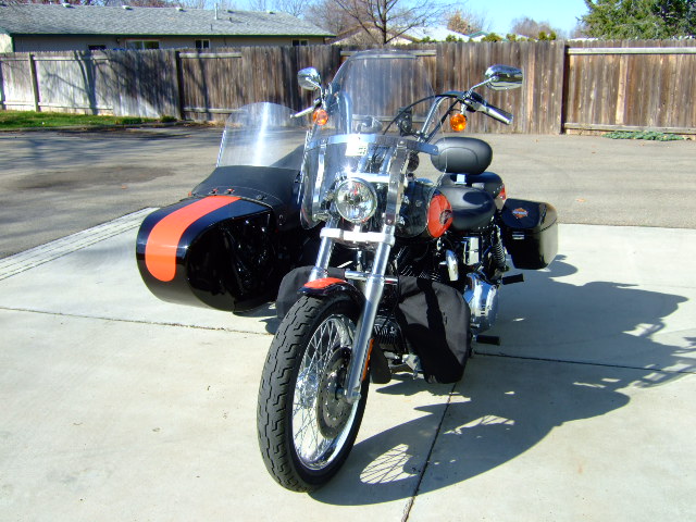

Hello Brock,
Speaking of "I just want to set the record straight," one might add the Early Velorex 562 and 700 models had the skinny 15mm axle, non adjustable shock and were built for the 350/500 Jawa bikes. The 2004 and up Cruiser and Tour models are for larger bikes.
The current Velorex models have been upgraded quite a bit from the 562, 562E and 700 standards to accomodate middle weight cruisers which are a large size of days motorcycle market.
I agree that they are way too light of a unit for the big Hondas,, Harleys and other touring baggers and big cruisers but they are no longer "Built just for 350s".
(I hope, you finally got the shop wiring and TIG setup working better than when we did my '08 FXDL show & display rig.) It did handle great though. With a 563T Velorex and a Troyka.
