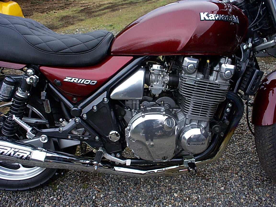

We do not make a sub frame for your bike as there is not much demand, we have been doing this for almost 20 years and have only had one KZ1000 in the shop in all that time. I would not recommend any Velorex on a bike as large as the KZ1000. If you are trying to stay on the lower end of the price spectrum with a new sidecar you might look at the Sputnik sidecars we have. Similar in looks to the Velorex but much stronger and heavier $3295 which does include mounts however all we could do is either supply "universal" type mounts which in general means it fits nothing universally or we can provide mounts for the ZR1100 which is similar to your bike. I have attached photo's of the ZR mounts.

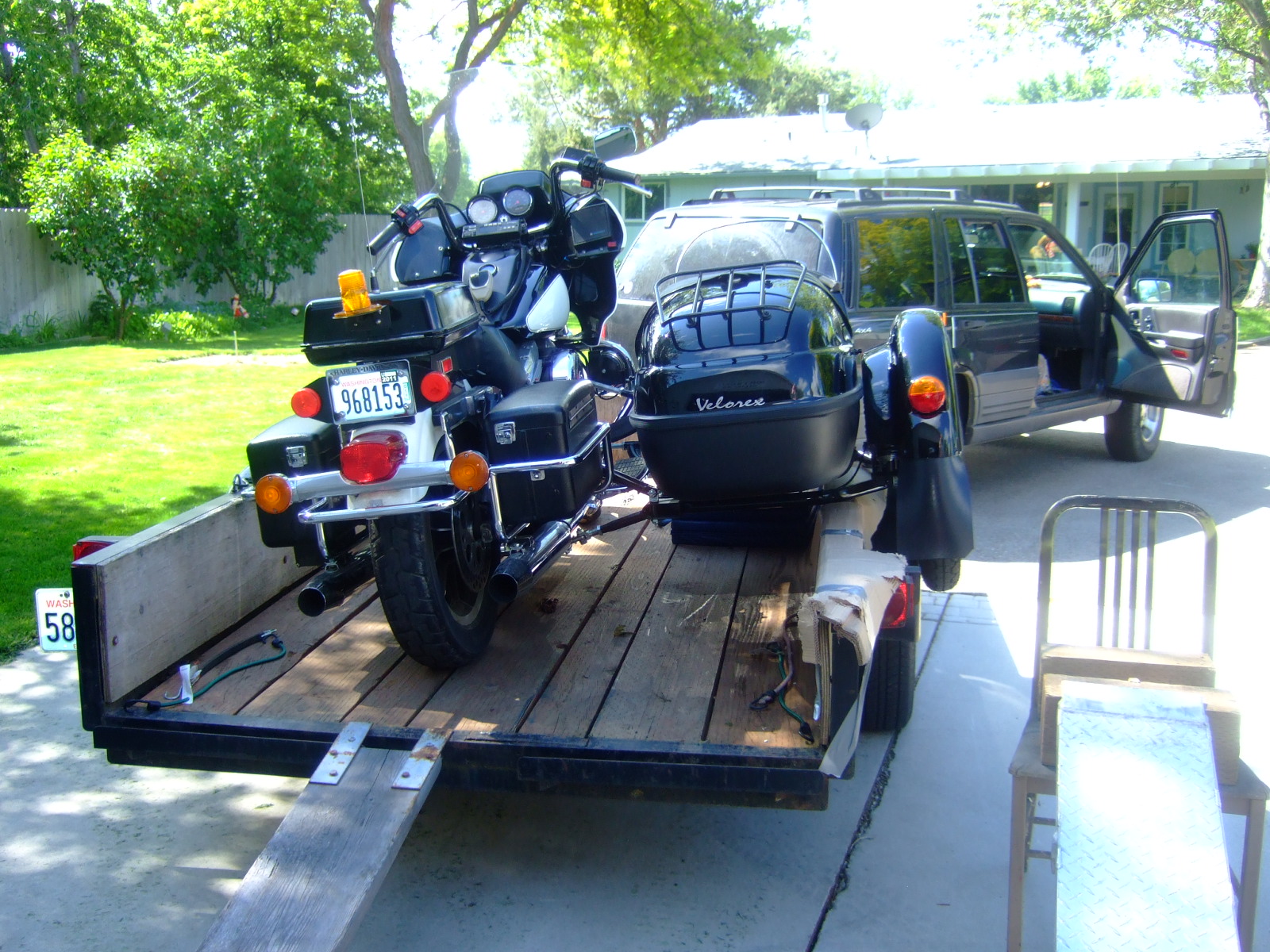

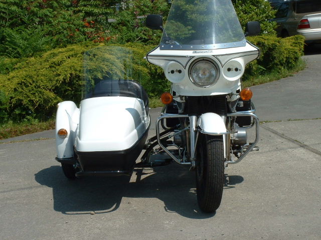

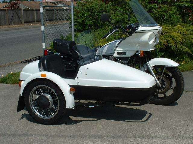

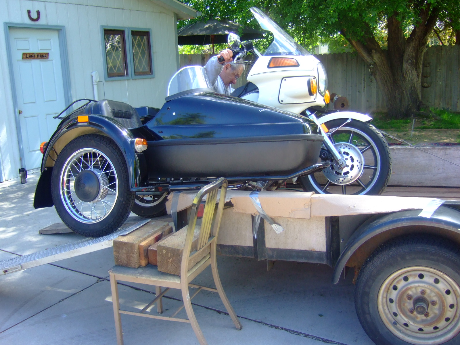

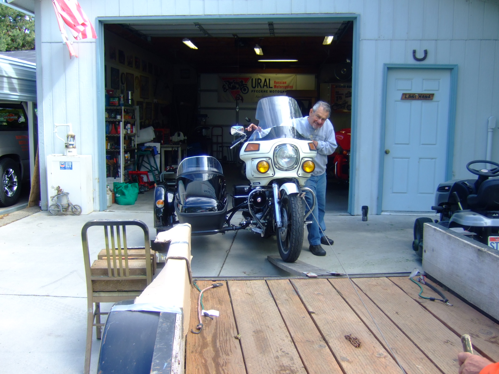

Here are two of the KZP/Velorex 562 rigs we set up with a combination of our mods, brackets and Velorex mounts. Worked just fine with some sidecar ballast. Sometimes using steel plate bolted to the hack frame with pad eyes and sometimes soft removable weight in the trunk.
NWSC Ret'd.
Posted : March 2, 2017 5:13 am

Lonnie......I should have known. Yes, I understand the Velorex might be a bit too light but I've seen a lot of photos of the combo. This wouldn't be any different than my BSA rig, in that I'm not looking to carry a passenger just cargo. AND.......if you know me I carry everything including the kitchen sink. I bring along enough tools alone that even if I'm not on a camping trip.....I have ballast.
I don't want to start a flame war.......I would agree ( but I'm STILL at the lower end of the learning curve) the Velorex might be a bit to small for the KZP.......but I have to admit, I love the look. That white on white combo in Lonnie's photos is just what I had in mind.

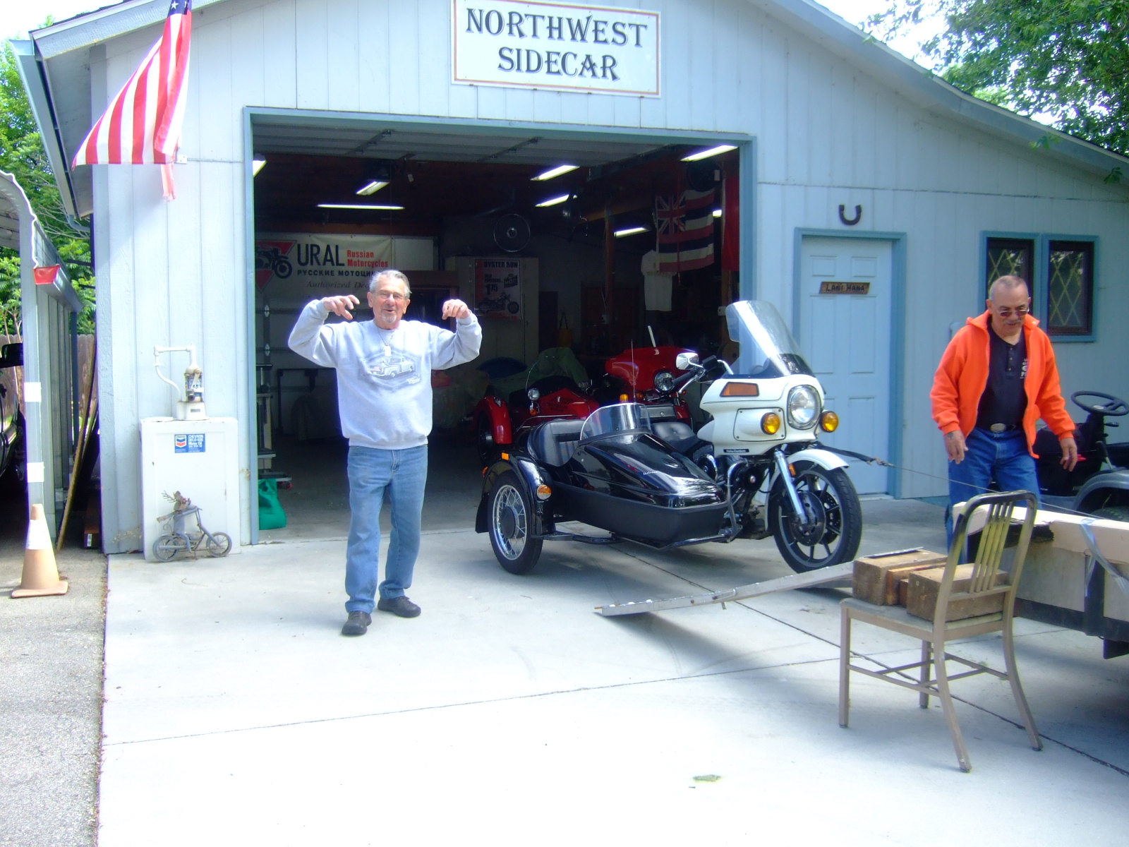

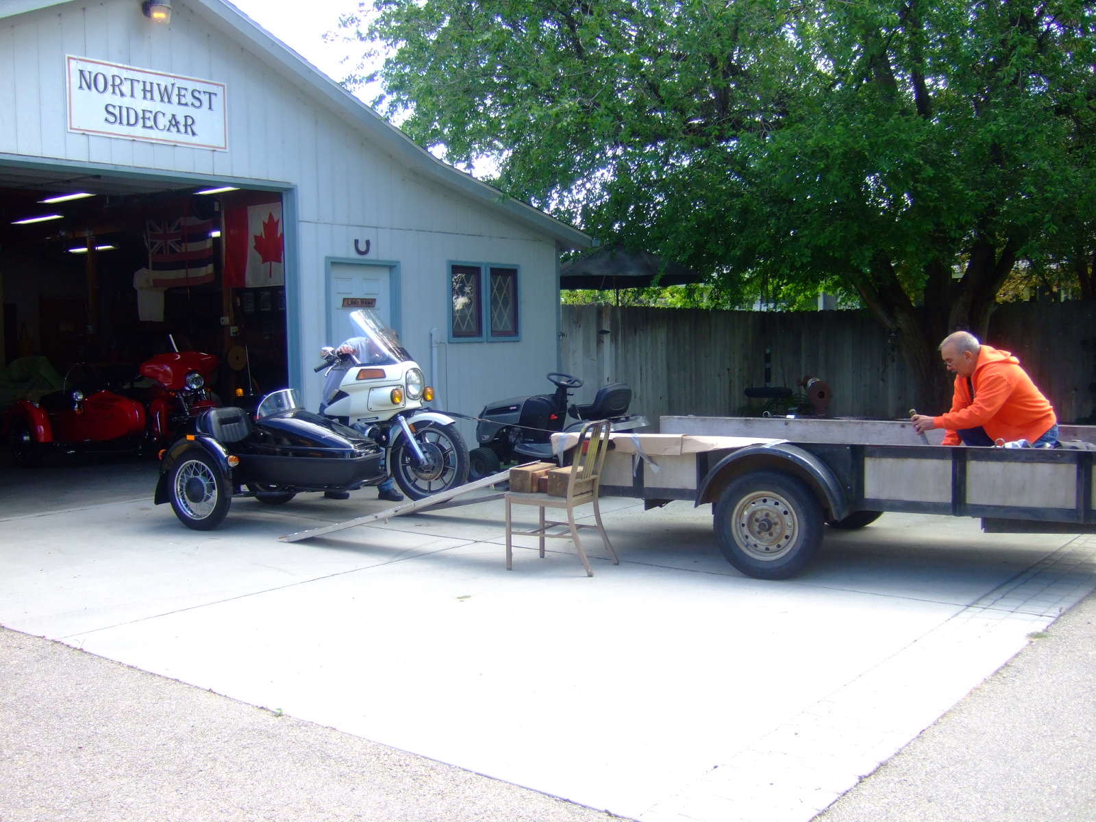

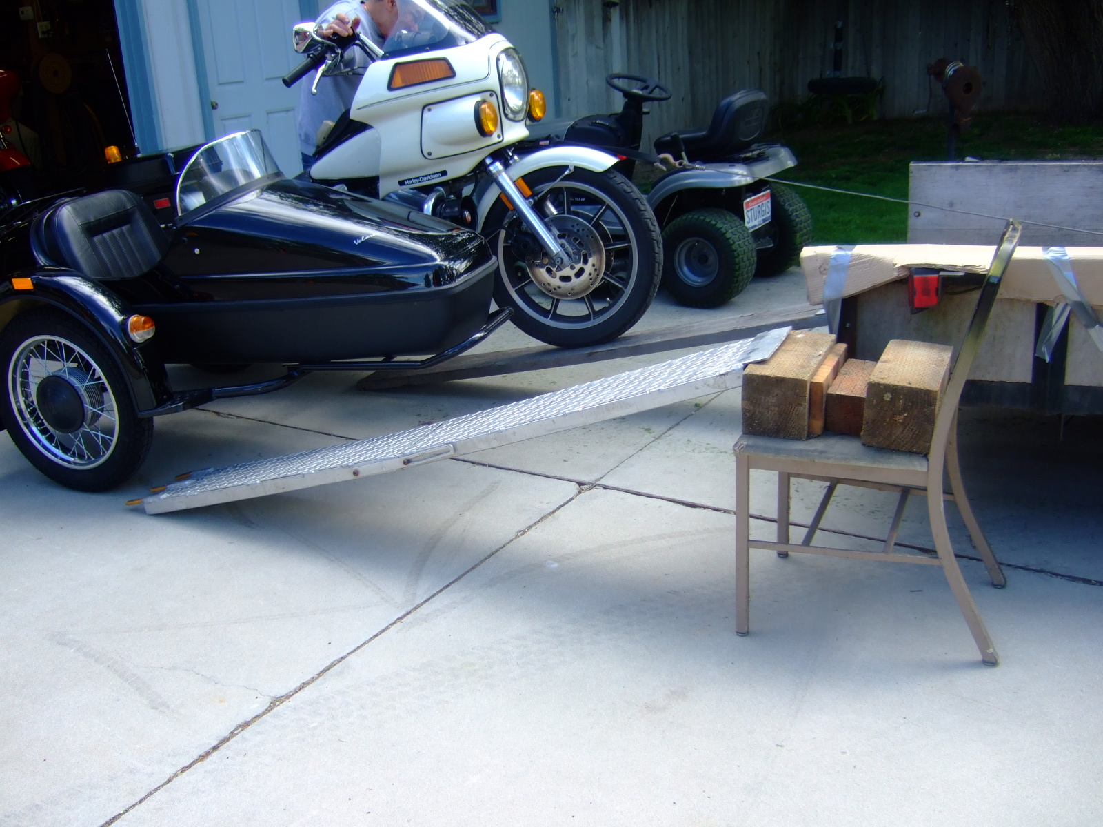

WAIT A MINIUTE.........................................HOLY COW Lonnie where in the heck is that chair wheel heading to on that black and white rig????????? Geeze......is it going to ride on the outside of thr trailer?????
Looks JUST like something I'd come up with.

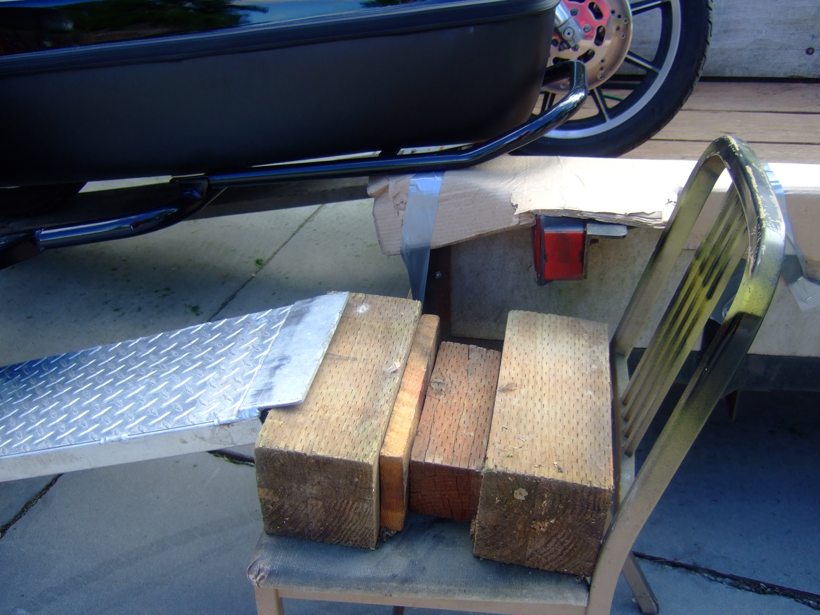

Yup,
Trailer just a tad too narrow for the rig. Didn't want to scratch it up so we Jerry rigged it for clearance.
Looked odd but worked well.
NWSC Ret'd.

Okay.....that's just beautiful!!!! There's a lot of folks that would just shake their heads at that set up but I have too admire that "can do" attitude and the thinking out of the box. Perfect.

it would have been funnier if there was video of him riding it up onto there. 😀

Here's what kills me......2-6x6s, 1-4x4 and 1- 2x6 all the perfect size. I bet ya $20 he didn't even have to cut them. And......propped up on a chair....to get the chair on the trailer????? That is genius.
He'd fit right in here in Wilkes County.....heck, if he makes moonshine too, he could be mayor.
I'm not kidding, I LOVE IT!
