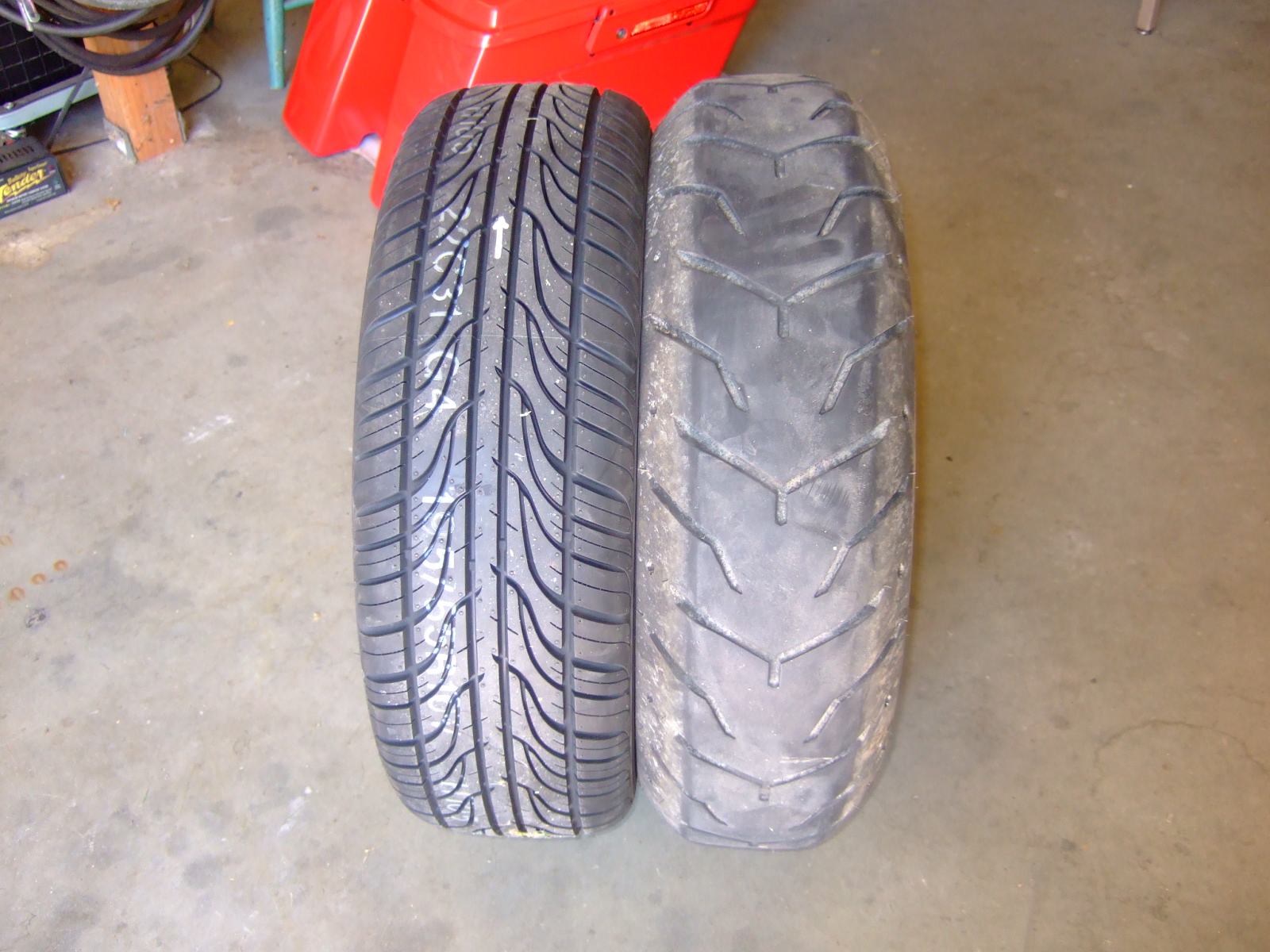

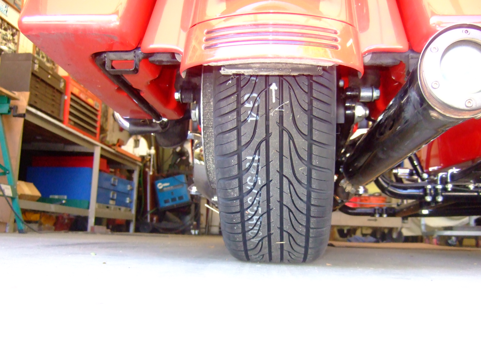

I've used Bridgestone and Hankook size 195/55/16 tires on my 2010 FLHX tug with no clearance issues.. They last about twice as long as the Harley Dunlop. Cost (from Tire Rack) is about 1/3rd of the OEM Harley 180/16. The flat tread tire has about 3 times the footprint of the round motorcycle tire, offering better traction and braking.
The auto tire is run at lower pressure (I used 28psi) giving a much softer ride.
