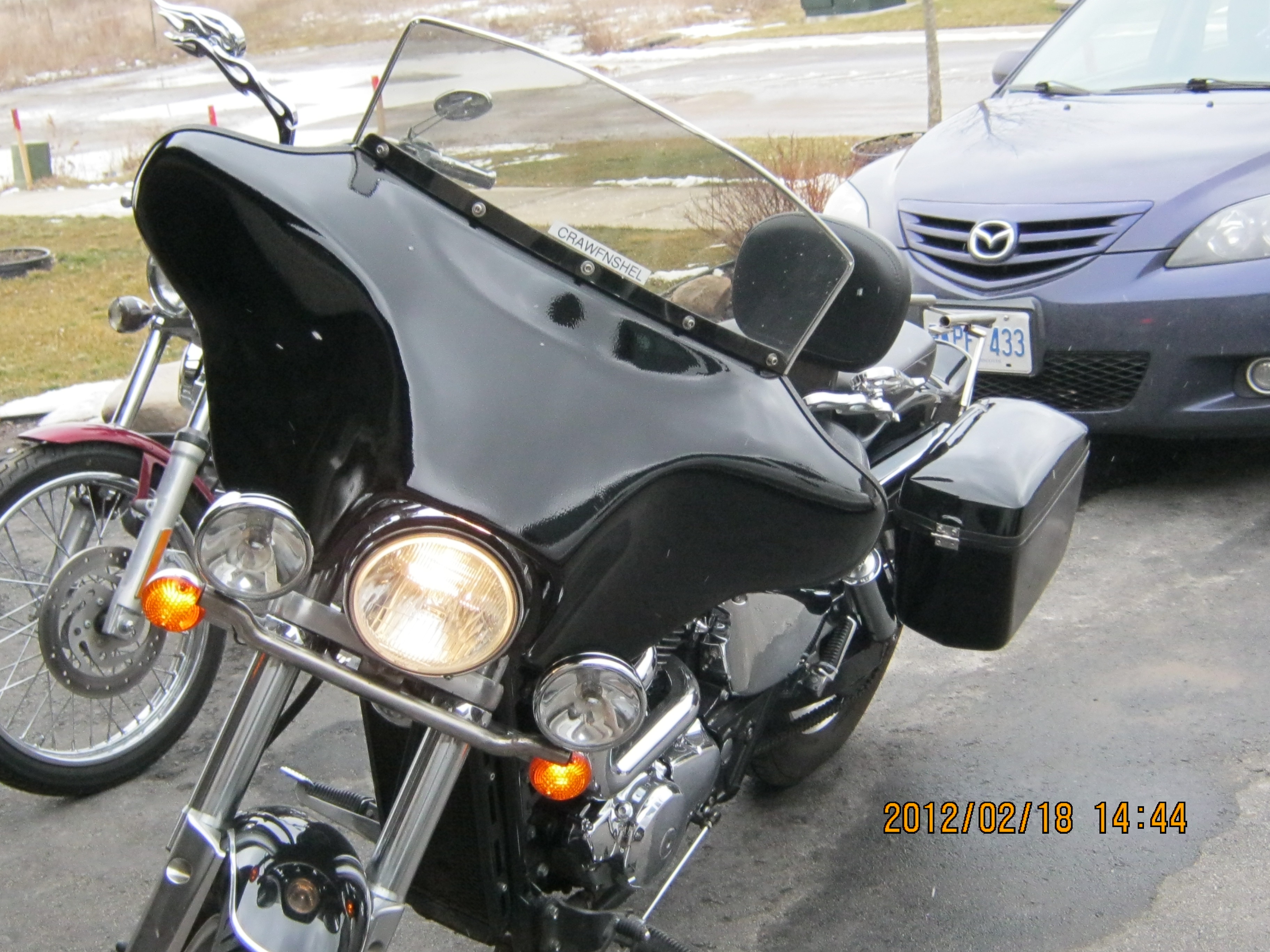

will do swampfox,..just for giggles here is a shot of before the work,.. cheers crawf.
Posted : March 5, 2012 1:48 am
