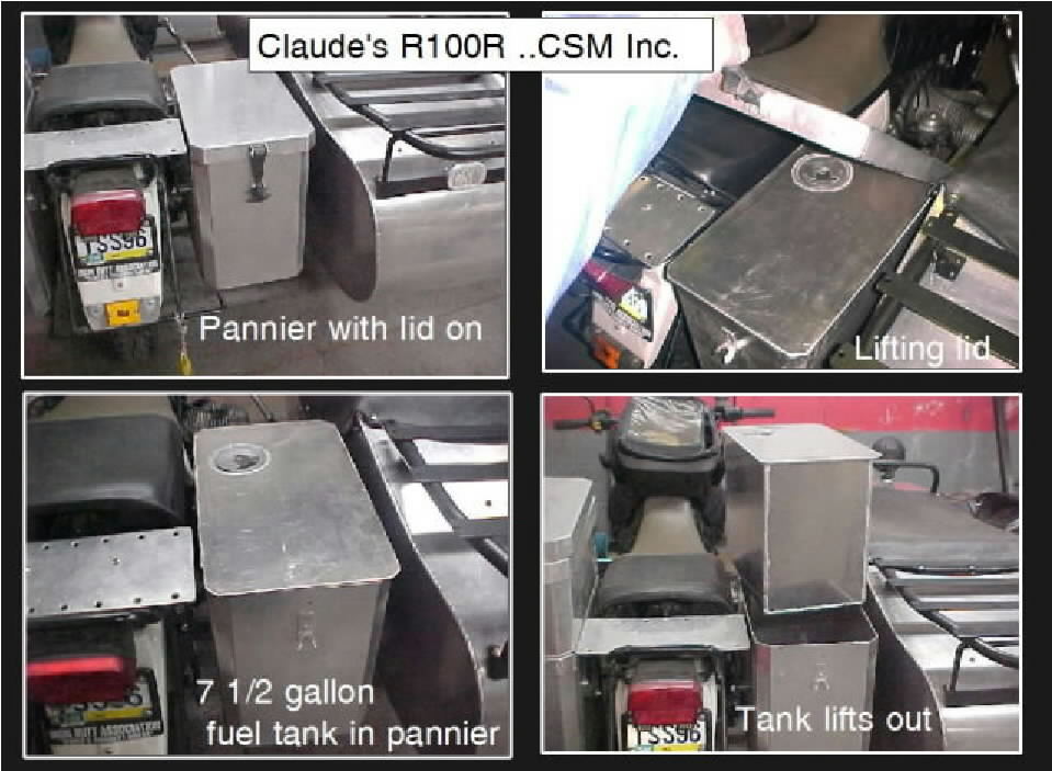

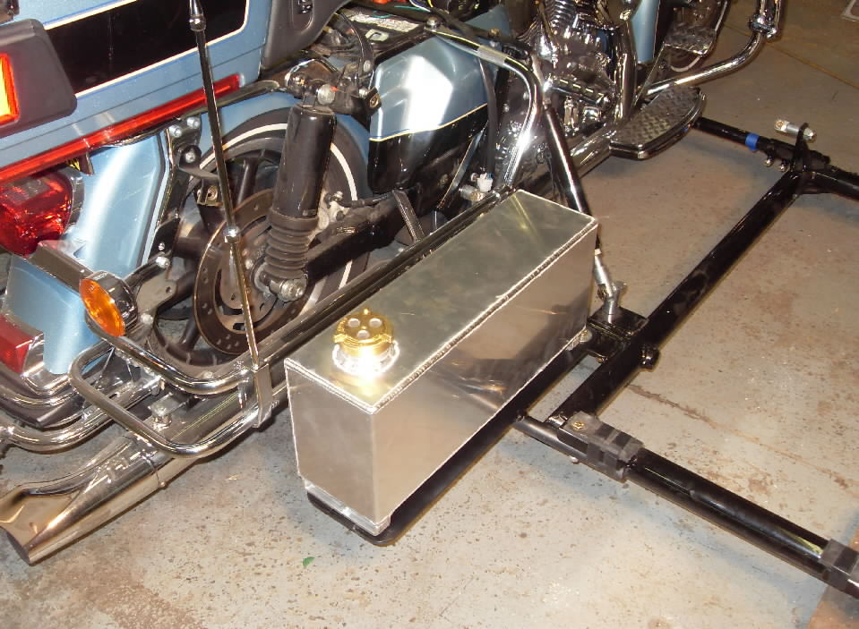

Make sure it is vented well Joyce. If fumes develope they may 'vent' themselves 🙂
'Jaz' makes some inexpensive units that work well in many applictions.
There are also the spun aluminum fuel tanks that come on various sizes.
Here is one source:
http://www.tourtank.com/
Couple of pics attached below. Lots of options.
Safety must be paramount though.
