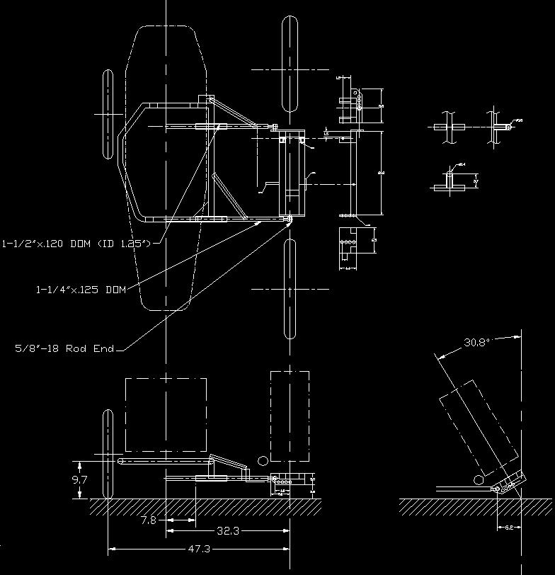

Hello uralsharps,
Unfortunately (fortunately?), I was so satisfied with the out-of-the-box performance that I already cut the bottom portion of rear mounting plate (it touched the ground in left turns.)
So I have no ability to experiment with different offset.
My two "connecting pipes" are designed to slide in the outer pipes welded to the sidecar frame but I didn't think about distortion caused by the welding. (They were MIG welded. I should have asked the welder..)
So now major tow-in change is a (relatively) big deal. I can still fine tune it at the heim joint, however.
I went out for the second time and thought that steering issue was more like low speed wobble I felt with the rigid rigs. It occured @ low speed straight run also. So maybe the steering damper is in order? (But don't want to buy those $500 ones for modern bikes. Where can I buy VW damper?)

Here's what I did.
I used existing center stand brackets for the rear and generic U
clamps came with Velorex for the front. The two clamps are attached to
horizontal portion of cradle frame as forward as possible.
Left one goes straight down, right one needs to be tilted to go
between two exhaust headers.
The subframe is constructed of 1/8" thick 1-1/2" square steel tubing
and 3/8" thick front/rear mount plates. I used 5/8" race spec CroMori
heim joints. The connecting pieces are 1-1/4" OD 1/8" thick DOM
tubing.
Two 1-1/4" ID DOM tubes were welded to the sidecar frame so that the connecting pieces slide to adjust tow-in and track width (unfortunately they don't slide any more due to welding distortion to outer tubes..)
Currently rear pivot point is 4" closer to the sidecar from the bike center line. Front pivot point is 5" higher than rear and on the bike center line.
Rear pivot point is 3-1/4" above the ground (no rider/passenger/luggage).
I adjusted front/rear suspension preload to max. I weigh 145 lbs and the rear mount plate does not touch the ground under normal riding.
The track width is 52~53". Tow-in is 3/4".
