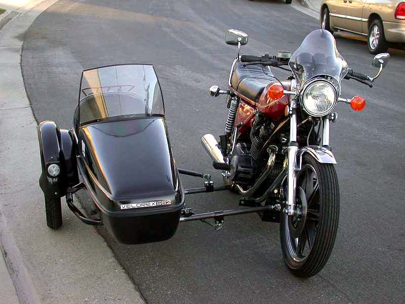

I finally did it!
Just made my first ride today.
Thanks to all the forum members who helped me especially DoubleA and uralsharps.
Well, it handles like a motorcycle.
So maybe it's not for typical sidecarist.
But it suits my needs.
I can take my 3 year old son to everywhere I go without worrying about flying the car in tight right hander or tipping over in fast left hander.
To uralsharps:
I moved rear pivot point 5" off the center line.
I didn't feel any pull on either side when I went one block with steady 50 MPH. I know this is not enough testing but that's the first impression. Maybe because my Velorex 562 is much lighter than Ural..
To snowbeard:
I see you lurking in BritBike forum. How is BSA A10 coming?
Any plan to work on the sidecar project again?
And finally here are some pictures.

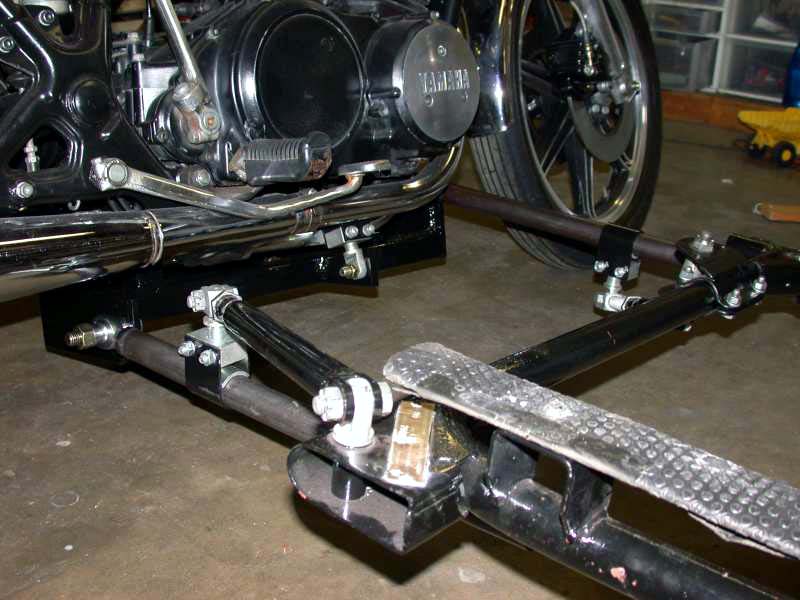

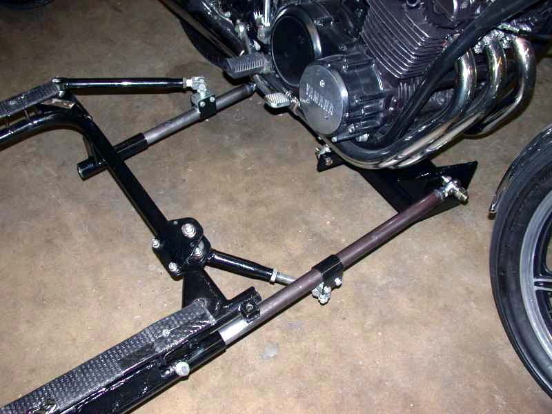

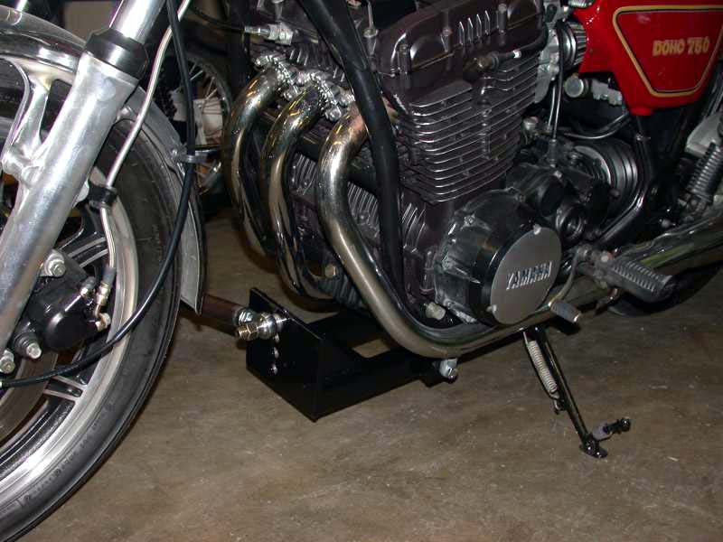

Very nice job. do you have any pictures of the mount on the bike and how it was done? lease keep us informed of how it goes. Well done
Posted : October 6, 2007 5:29 pm
Thank you!
The sub-frame is attached to the bike frame at four points.
I used existing center stand brackets for the rear two points.
For the front two, I used U clamps came with Verolex. Left side goes straight down. Right side had to go between two exhaust headers so it's tilted.

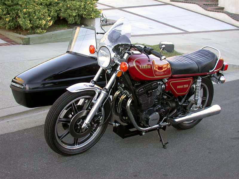

Thank you.
Here's what I rebuilt so far.
Thumper '79 Yamaha XT500F
Twin '71 BSA A65T
Triple '78 Yamaha XS750E
Multi '75 Honda CB750K5
Next one... Honda CBX or Benelli SEI (nah, too expensive for me)

so are the unpainted "legs" going to the bike a part that you added on? and the tensioners at an angle from them, were those originally attached to the steed before it was a leaner?
is that a third hiem joint in the middle to get the plate mounted between the two exhausts? or just a linkage to extend it?
It's a U clamp came with the Velorex as a part of generic mounting kit. I put another one on the right side also.

That's how I plan on mounting my homebuilt rig. Let us know how it handles with the mounting points on different planes. I thought they would have to be the same front and rear. That was the problem I saw with mine as I don't have much ground clearance at the rear, and my exhaust is low on that side as well. If yours works fine like that it would make mounting mine much easier.
Posted : October 9, 2007 3:56 pm
I am pretty much satisfied with the out-of-the-box behavior.
As I wrote in the thread in Technical forum area, I rode through the twisties I frequent on both solo bikes and rigid rigs. So I can compare the feel fairly accurately. I don't really feel the existence of the sidecar during accel/decel/constant-speed/left-right turns.
I made a provision to experiment with front (up/down) and rear (left/right) pivot points but I already cut the rear mount plate to increase ground clearance. No adjustment at the rear any more.
Off-centering rear pivot point to the right (sidecar side) gives me more lean angle without sacrificing the ground clearance also. I had a similar issue with exhaust/muffler interferring. I think most bikes have similar issue unless you live in UK or OZ and you have 4-into-1 header or something.
The track width is about 52". The sidecar weighs around 150 lbs plus my son's weight (25 lbs). I can give you the wheel lead number if you need. It was determined by the dimensions of motorcycle and sidecar frames. I didn't have much room to consider.
Posted : October 9, 2007 4:39 pm
Skiri,
Congratulations! I've been away from this site awhile. Looks like a great job. You are obviously pleased in going this route. The bad thing is you'll never want to go rigid again. I think your handling issue, "grave road" feel, could very well be due to the amount of offset you have in rear mount. I felt a bit of that after offsetting my front mount. I believe the dynamic forces pushing offcenter of the frame causes this. However, I believe this is a tradeoff for tracking either right , left or center. Mine seems to track to the left but not as much after adding the offset. I would be interested to hear just how any other mounting point adjustment have on the handling characteristics. I think I'd like to have a higher front mounting point but I'm not sure. For instance if I inadvertantly allow the sidecar tire to get too close to the edge of the road and I suddenly lean to the left to bring it back, the tire will initally get even closer to the edge(or go over the edge) until the bike begins its left turn. If the mounting point were higher up a sudden left lean would instantly pull the tire away from the edge of the road. However, I think this extra mass up high will also slow the bikes responsivness. My best guess is that the ideal hight would be at that spot that is fairly "nuetral" during the lean process.
