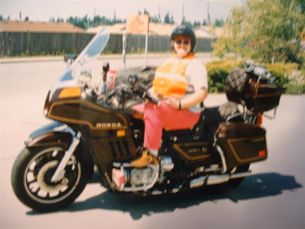

I've helped several folks with different degrees of physical limitations get back in the wind on bikes and scooters with hacks.
From little old ladies to paraplegics. Largest rig was a 1100 GL/562E combo with altered controls for a partially paralyzed 53 year old woman who couldn't use her right hand and carried her wheelchair in the hack.

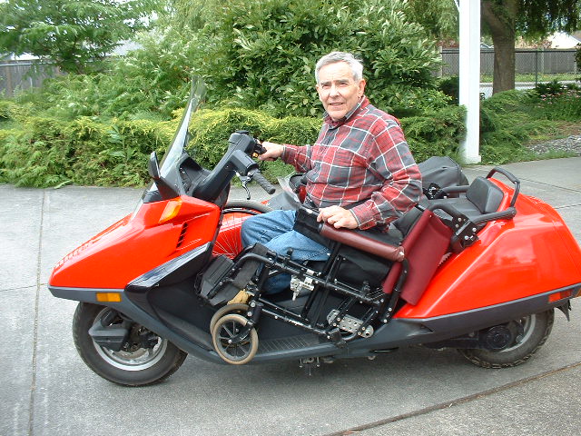

The smallest was a Honda Helix/Cozy setup for paraplegic use. This owner made his own wheelchair rack and further modified his rig. This is his third year with it and he loves the mobility.

Hack'n- re "Brad on Helix-Cozy #3"; is that an older Cozy? It looks cool, but I've never seen it before.

Brad's Helix/Cozy chair is a current model Cozy 100. Seat and windshield were not installed at the time pix were taken.
