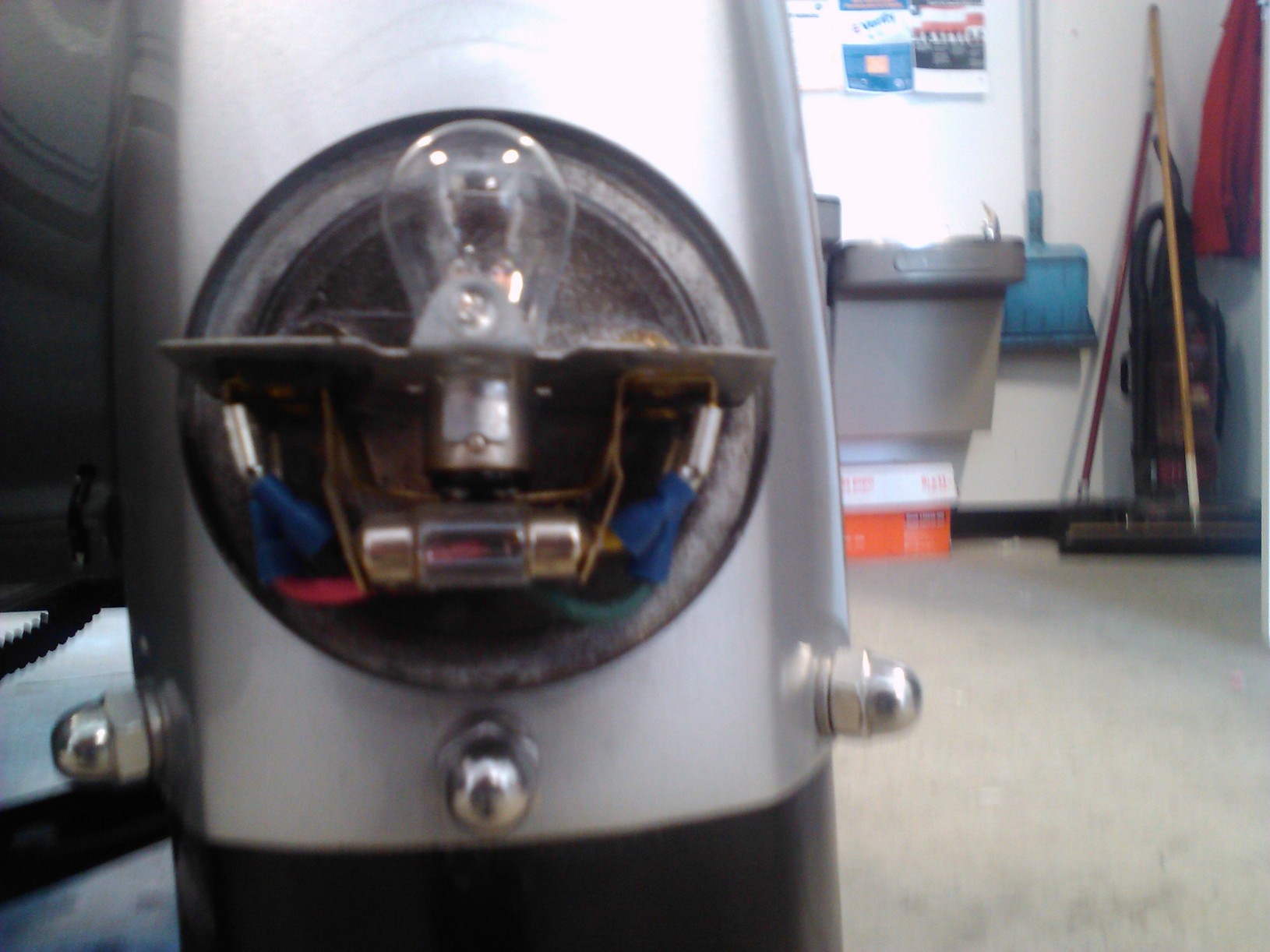

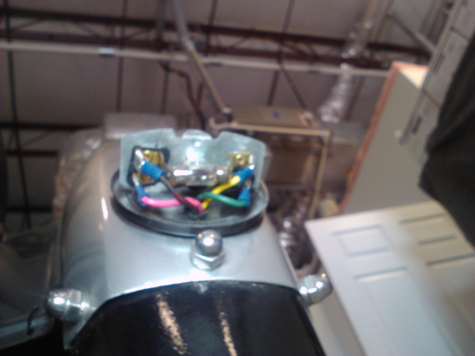

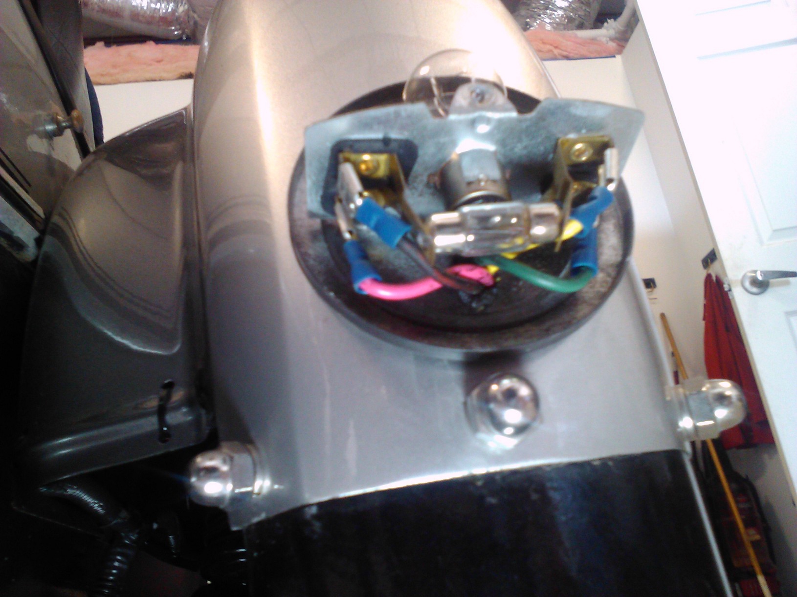

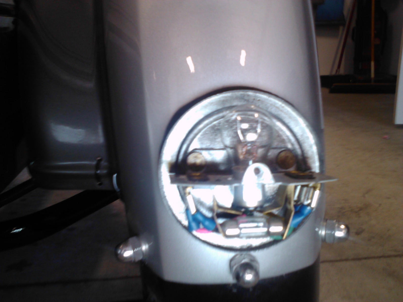

I have a mid 70s Velorex on my Sporty and it has an 1157 bulb on top and a "interior" style bulb under. Unless someone changed my light housing. with no wiring suggestions I just hot wire tested each one till I figured out what each one went to . I will look to see if I have a pic of the rear light housing

just remember a weard thing with this light: As you are somewhere in potential nirwana and not metal ground. The moment the ground fails just a little you do not get a flasher, but a flashing stop light or run light.
Tie down well the base plate for a propper ground in each sidecar light. Just for to prevent surprises and perhaps a traffic ticket for wrong working lights.
