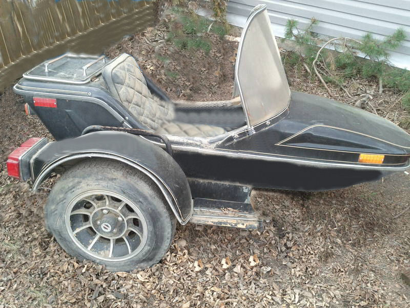

Can't seem to find the serial number for my hitch hiker side can I just purchased...did they put one on and if so where should I be looking..I've looked everywhere on it for one.
Also can't find out who made them and if this company still exists.
Any help would be appreciated.
Thanks
Posted : June 8, 2011 7:09 am
Originally built in Minnesota by Bob Loberg. Molds sold to Pat Sheehy. I believe they were last built in Ohio . Not in production for some time. They probably went out about the same time as most other US makers in 1982-'83, when Federal Product Liability Laws were expanded. Most small builders couldn't afford the insurance so they faded into the sunset.
Posted : June 8, 2011 10:22 am
Hitchhiker was originally built in Minnesota by Bob Loberg. Molds sold to Pat Sheehy. I believe they were last built in Ohio . Not in production for some time. They probably went out about the same time as most other US makers in 1982-'83, when Federal Product Liability Laws were expanded. Most small builders couldn't afford the insurance so they faded into the sunset.
