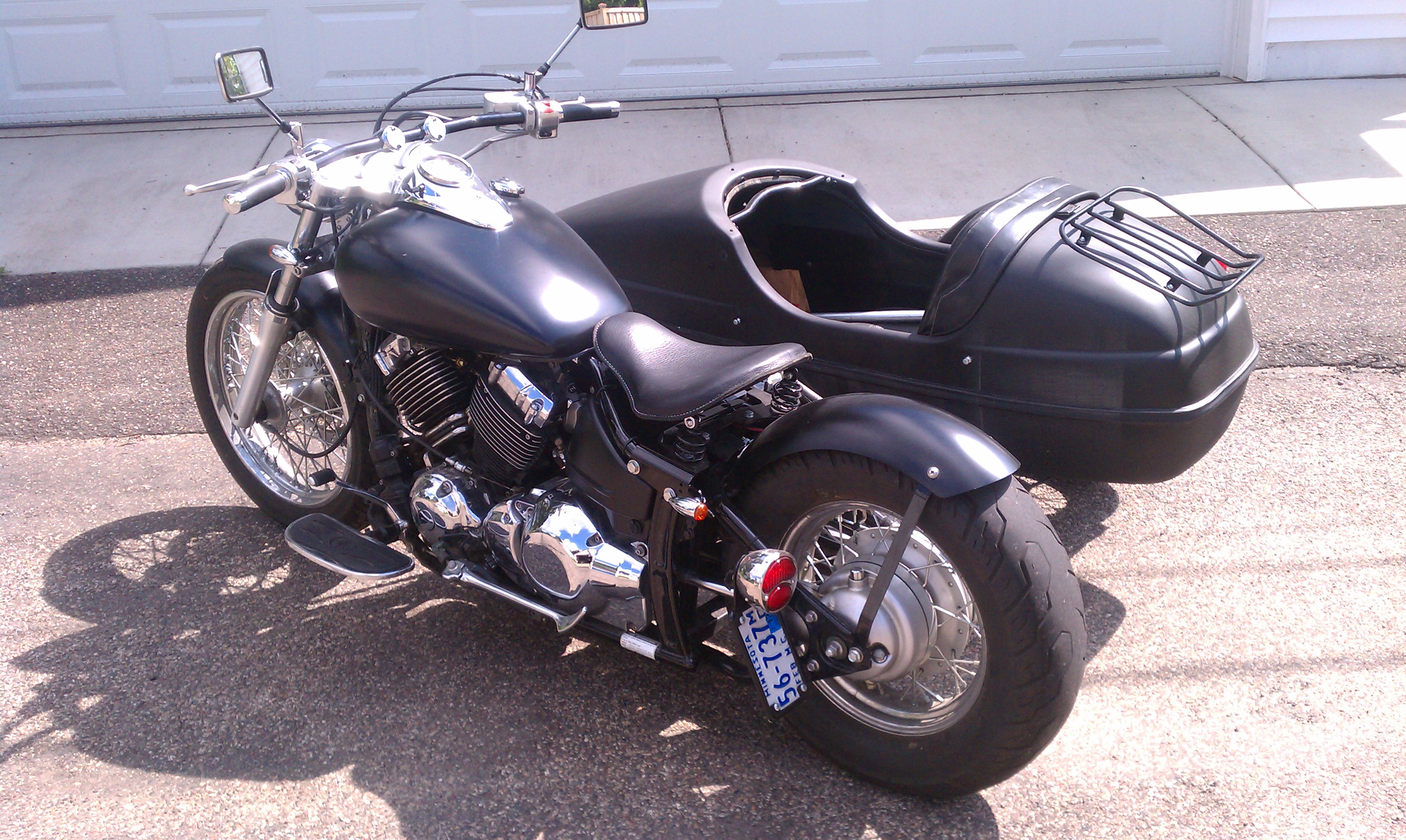

My rig is a V-Star 650 with a Velorex 562 on it. I did get the bike specific mounts but everything on the bike is stock. It handles really well, no wobble or pulling of any kind. I love it!

I also have a 650 V-Star / Velorex combo. I also used the DMC custom mounts and they worked well. I feel it to be a good combination. The low gearing of the V-Star pulls the rig along strongly.
