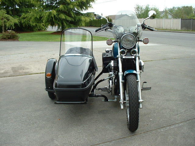

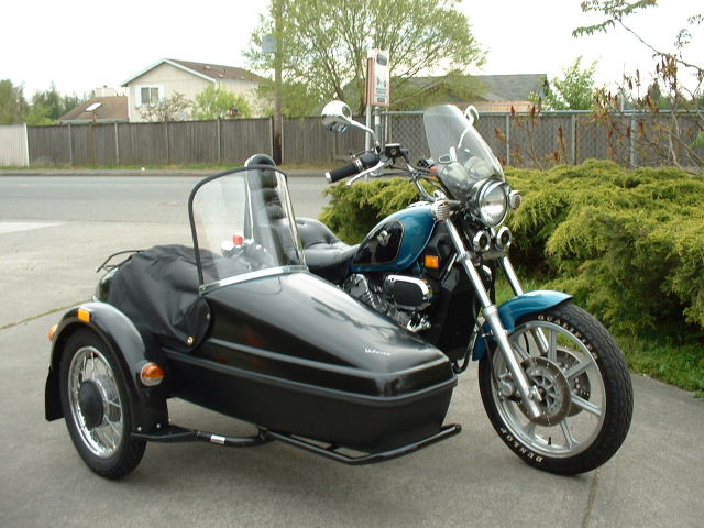

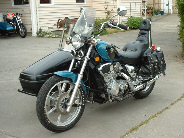

Here's one of the last VN750 rigs I put together for a client.
Velorex 562 Cruiser sidecar, no damper, Smooth installation with no head shake. Well balanced outfit with good power. Happy customer.

I put a spffy new Velorex on a VN750 an it worked GREAT. The Velo was a near PERFECT match weight wise for the Vulcan. Power was excellent, handling was excellent. I can't say enough good about what a sweet package it made. Darned shame I didn't take any photos of the rig. Sorry. I'd gladly help you put a hack on your Vulcan if you want though.

Hey Lonnie, other than the color (mine's black and silver), that's my bike! What a GREAT looking rig!!
Other good news from you both that the Velorex is a match for the VN750, with good handling and no headshake.
