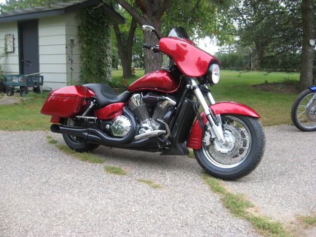

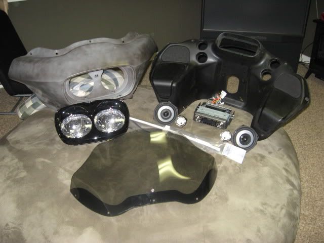

My VTX is dressed out at the moment. I actually have a full RoadGlide fairing waiting to go on if I do mount the hack to it.
But it isn't quite as cushy as the wing LOL

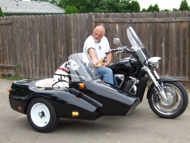

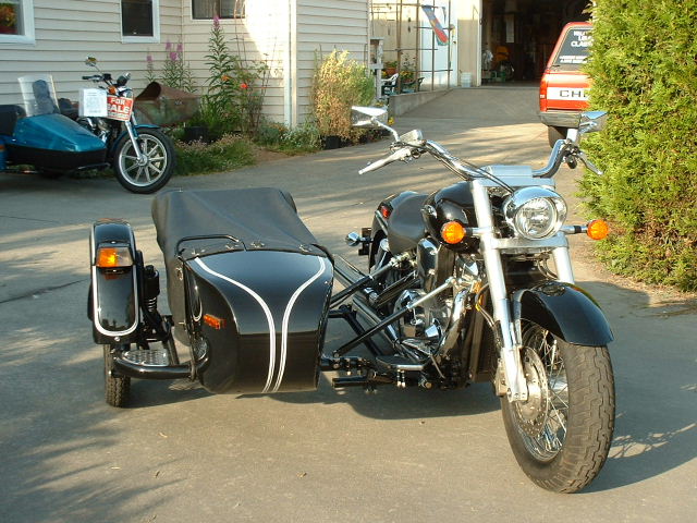

No Cal III's but here's couple of VTX 1800 rigs.
Posted : June 30, 2011 4:36 am
(@billy_bob169)
Posts: 80
thanks for the pictures. That Bavarian Classic one looks nice! good retro look for the VTX
