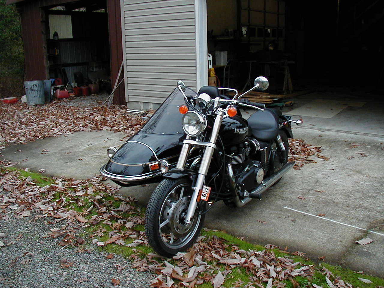

Well here it is, finally. I don't think I would ever tackle a project like this again. I have had the hack on and off the bike 4 times and I think I finally have it almost aligned properly. Steering is a bit hard, but manageable. I have only ridden it in our subdivision and up to 40 mph. Gotta get used to not leaning into turns. It tracks well if I get in the center of the road crown and no wobble in the steering.

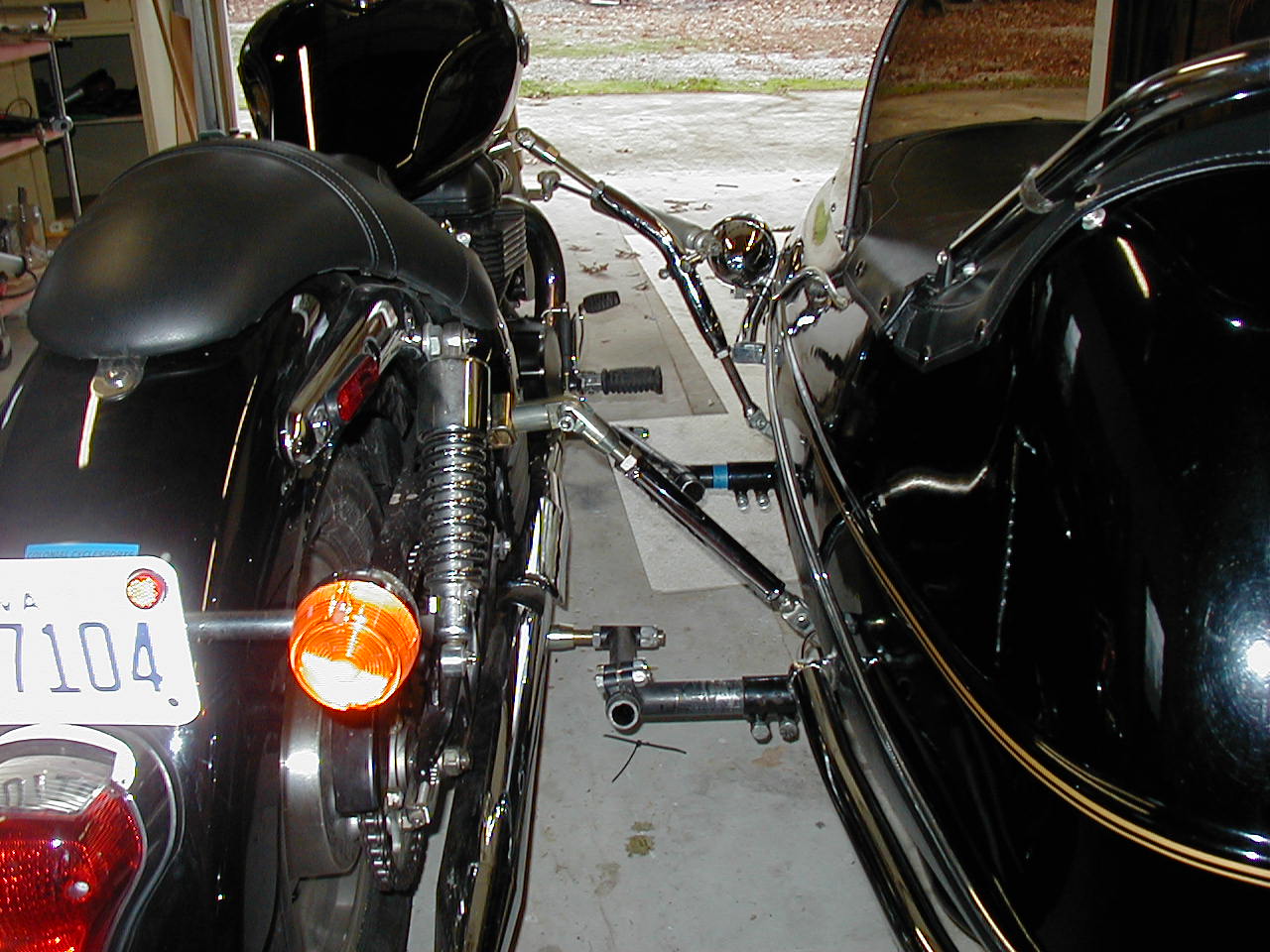

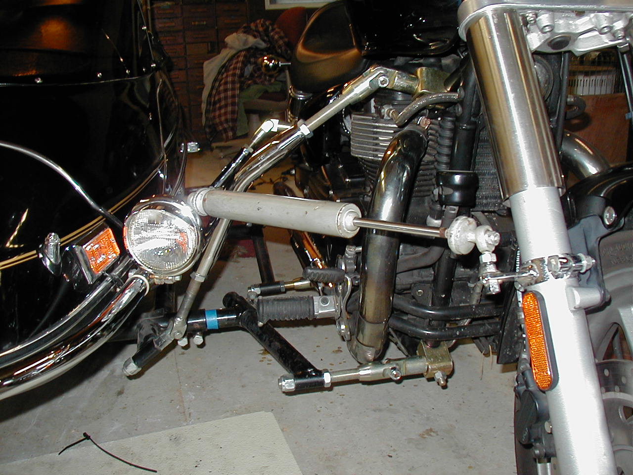

I have been making adjustments and doing test rides and I think I am there. I worked on the lean out and have it tracking pretty straight now. I also remounted the hack and now have about 10" lead as opposed to the 14" lead that I had at first. I also added the steering damper although I didn't have any shake, it seemed to stabilize it some.
Been riding around the subdivision and had a warm day earlier in the week and took the rig on the highway up to 55mph. Straight aways and gentle curves go pretty well, sharp curves are a bit challenging still, but are manageable. I do not want to modify the steering as I like to disconnect the bike and ride solo sometimes. I am also learning the effects of the throttle on the steering. I just need a LOT of practice.
I also completed the wiring and now have all the lights and signals working.
Attached are some pix of the connections.
