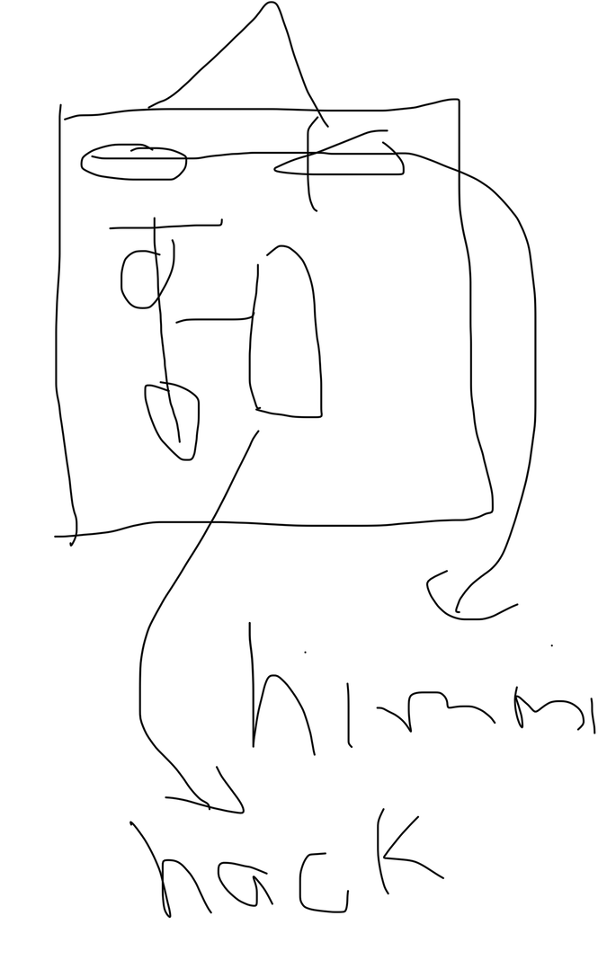

(@guha-ronniegmail-com)
Posts: 93
@miles-ladue ok then I misunderstood “Himalayan cross ways on the front of the trailer bed”
 you meant like this, no?
Ch mini
———— (Himalayan - length is 7.19 ft for the previous 411 model )
| | (sidecar plus INT650)
Like a T - no?
