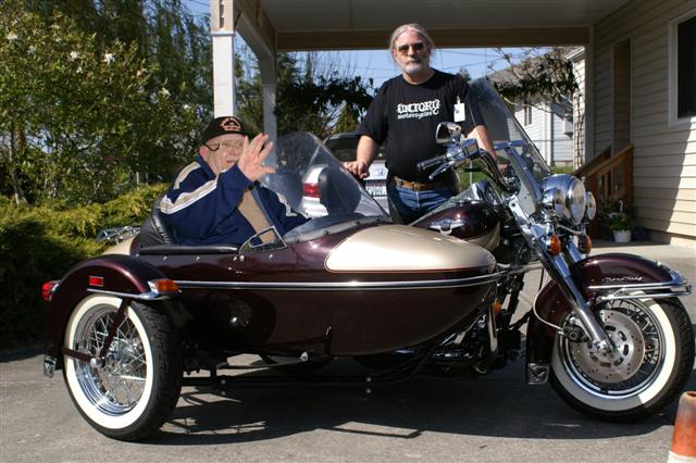

It had armrest cushions but no radio.
Here's a shot showing the armrest pads and handgrips.
Posted : September 24, 2007 6:48 am

Yes, I see. It's possible that it was ordered that way or the parte may have been added at the dealershp but no matter either way.
