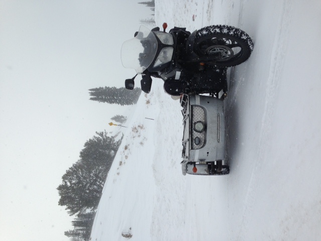

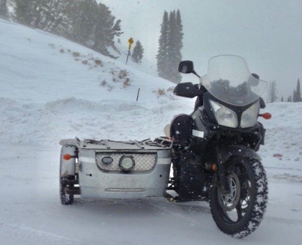

I took the rig out for a ride up Galena Pass last week. Studs front and back. The last turn to the top was a wide 180 degree sweeper . I was drifting up the whole turn and it felt rock solid. I don't know how fast I was going, but my truck could never match it.
Posted : December 24, 2016 3:59 am
