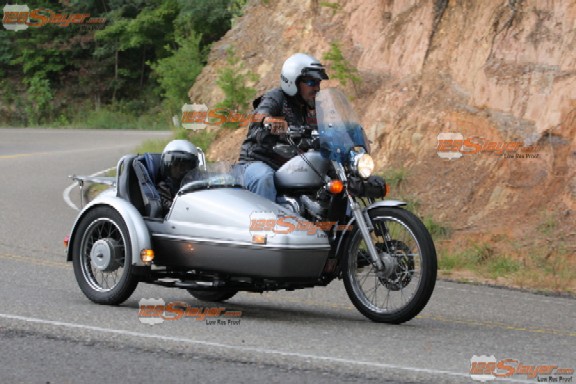

I have no experience with the older Goldwings, other than long-time Goldwing riders have told me the 1100cc model was their engine/frame preference, even over the 1500's. However, our first rig was an 2002 XL883R Sportster mated to a Texas Ranger sidecar, which I rode for 6 years until recently selling it to Paulau. The 883R was reliable as, well, a Honda, during that time with no issues. The belt drive was not an issue for us. The first modification to any Sportster is to gear is down a little, best accomplished by a smaller front pulley. We went down 1-tooth (4%) with an aftermarket front pulley and it made both 1st & 5th gears much more usable. I suspect a 1200 would do well with the gearing from an 883 model.
The 883R/Ranger combination became a comfortable short-range/weekend tourer (~300 mile days) after modifying the steering with a 5-degree triple tree, as the rig was not only easier to steer, but the minor pulls from road/load were also minimized, and the wobble essentially went away along with the bump-steer effect from the sidecar tire hitting road irregularities.
The vibrations in the sidecar from the rigid mount engine were not intrusive, and most every child that rode in the sidecar went to sleep within 20 minutes. The Ranger car is a good, balanced match for the Sportster and reasonably comfortable for passengers, but not as comfortable as the larger sidecars. Also, passenger entry/exit is also more difficult than some of the larger cars with step-thru or hatch.
Here is Paulau giving her mom a ride in the 883R/Ranger combination for the first time at last month's Uncertain?Rendezvous 2014:
