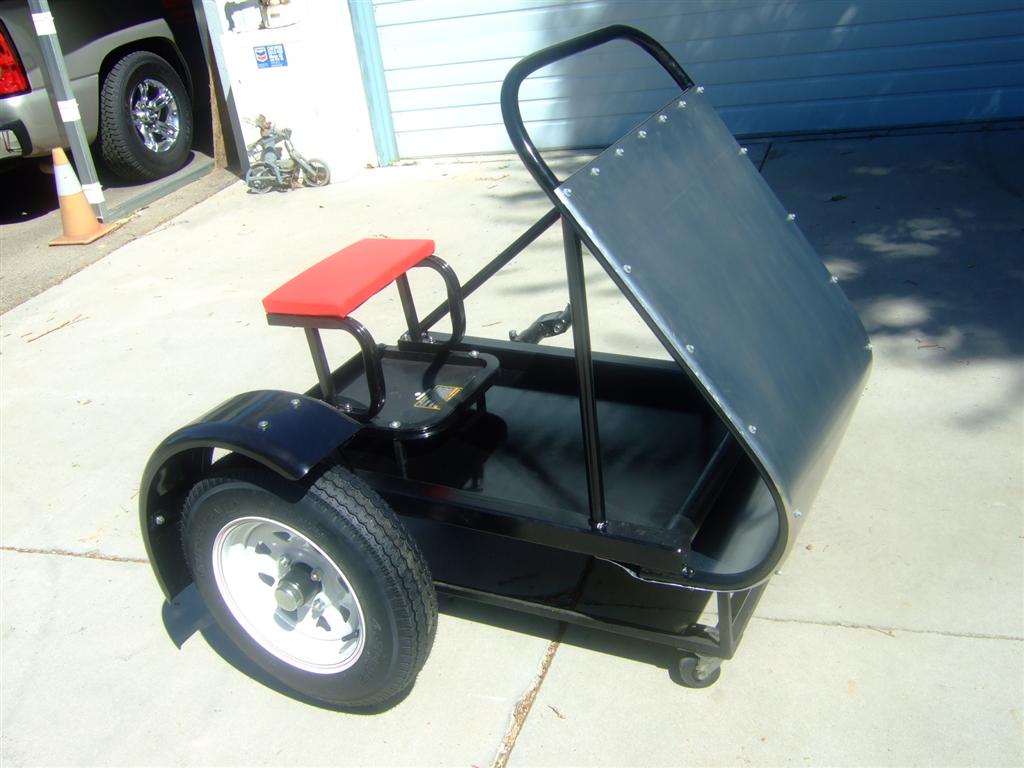

I have a Offroad/utility sidecar chassis for $1,295.00 with torsional suspension. It has a removable seat, a steel deck and comes with /2 BMW mounts.
Will palletize for shipment for no extra charge.
