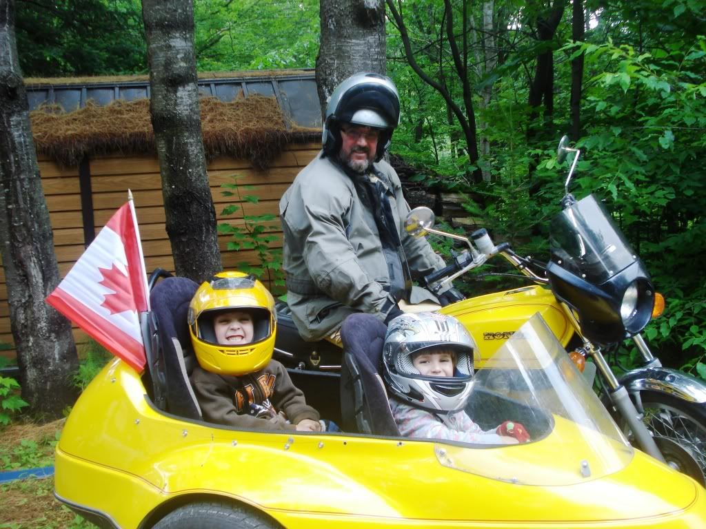

My current ride is a '77 GL1000 with California sidecar modified to fit my two kids (see attachement). I've had it for three years...I'm a novice. As my kids grow, I will need a larger sidecar and a stronger tug (in about two years). I was thinking of something like a Valkyrie. Does anyone know of problems/advantages of said bike? Any suggestions as to other bikes are welcome. This is my first post...I hope the link works 😉

Oops...no link...try again...
kidz I
see if this works...I read that I should take HTML code...it seems long but lets see...
