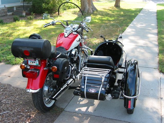

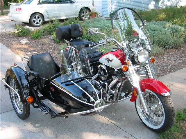

I've been working on a project with a Vulcan 800B and a sidecar. I went w/a lighter sidecar (weighs in at 196# rigged)and have the rig up and running. Have been on a several trips (500mi +). This Vulcan is a '96, converted it to belt drive and upped the ponies to about 55hp at the rear tire (dyno). Loaded w/gear (Rider 200# + Pax of 150# + gear 50#) it will run 65mph comfortably. Last trip w/wind (gusts to 40) and hilly country we averaged about 40mpg...highest was 46...lowest tank was 32. Into the wind (30 mph w/gusts to 40) 60 was working the engine hard... and uphill into the wind required a downshift to hold 50 mph. For shorter trips w/wind under 20mph, keeping 65 is realistic, but the rig seems to relax more at 60mph. Top speed no wind, on the level, is just over 86 mph. I did put progressive heavier duty (over stock) springs/valves up front, and adapted an upgraded aftermarket heavier duty rear shock/spring from a Suzuki 1200 Bandit for the rear. That combo has worked well. My take on this combo? I did it because I had a spare bike in the garage, didn't know if I would like hacking, and wanted to learn all I could by building one before I paid bigger bucks to have someone build me a "guilded" rig (if this turns out to be a "go"). We are pleased w/the experiment. As a first timer and novice hacker (been biking for 46 years), I've learned a bunch (with considerable help from folks here on the forum), the rig is fun and works as a starter rig for us. Next rig...I'd go w/more ponies because I tour more than I cruise...if I was commuting or crusing...I'd stay where I am.
Posted : September 26, 2008 5:37 pm
I went w/a lighter sidecar (weighs in at 196# rigged).
That Cozy must be ballasted to come up with that weight.
Posted : September 27, 2008 7:48 am
Correct Lonnie--that weight was for the car/all attachments/all accessories. Additionally, I filled in some of the "tub"-frame to add weight...and probably over-built the strut assembly/cycle sub-frame. Heavier than needed, but my wife reports the ride is very comfortable. I also note that even at night the lighting seems not to chatter...smooth transitions over bumps.I also noted after my late night foray in posting, that this thread was an old one with the initiator's account "deleted". Thought I was being so helpful. 😉
