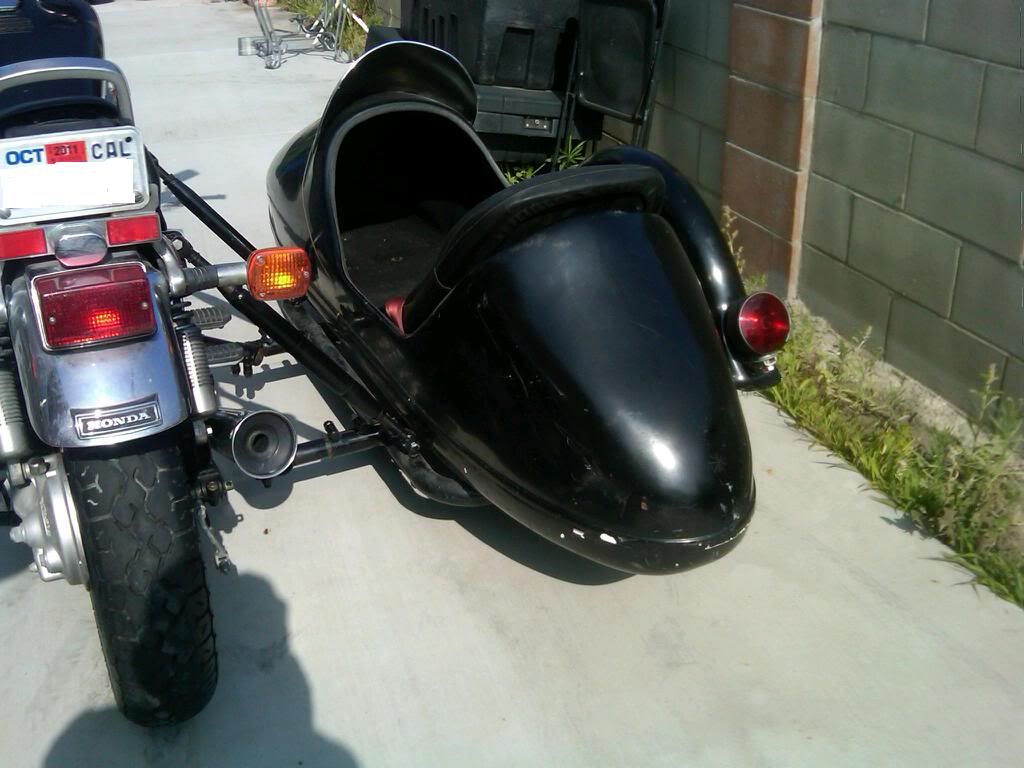

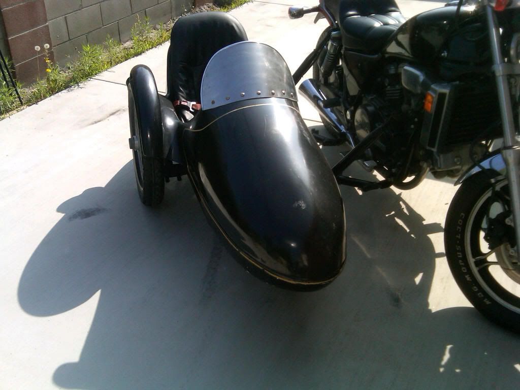

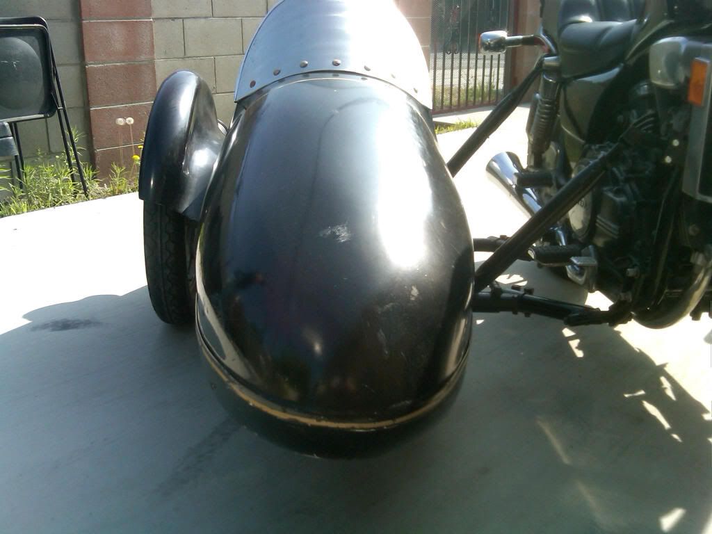

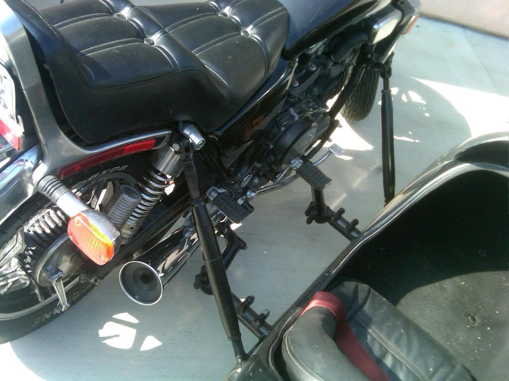

I'm new to sidecars and have been in search of a Spirit Eagle. I finally found one that comes with the mounts for a 1983 Honda Magna VF700C. Would any of you know if I can use these mounts to attach to my 1972 Honda CB750k? Here are pictures from the current owner. I just want to get an idea of how much it will cost me to buy new mounts if needed.

On the bike end it appears to have the old style ball and collet lower mounts and clevis and eyebolt for strut mounts . DMC has frame clamps for both types of mounts.
