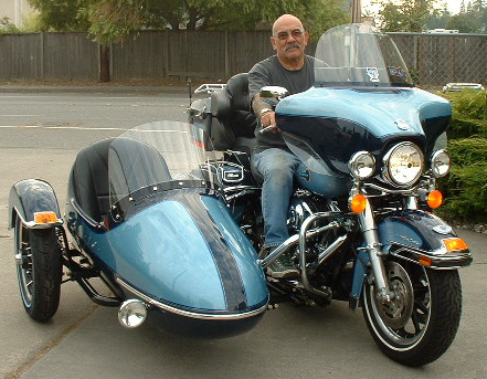

I have a matching TLE on my RK and I think that the combo looks great.
Having said that it is not easy for my wife or 90 lb Lab to get in or out.
In addition, passengers want use the not-so-sturdy windscreen as a grab bar and the fender is also partly in the way.
As for comfort, my wife is quite happy and overall likes the outfit. I adjusted the lean angle and toe in so that it now handles fine and is a pleasure to travel on.

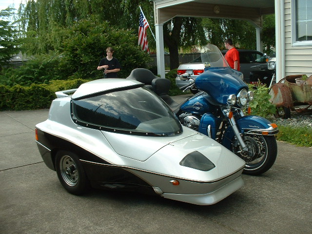

Here's another option.
Posted : December 29, 2007 6:47 am
