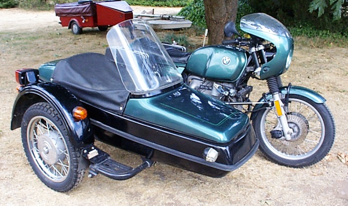

My wife would very much like to have a sidecar to ride in. We also would prefer to stay with just one bike, so I'm looking into possible sidecars to attach to my BMW R75/6. I've seen there are subframes that make attaching and removing the sidecar not too difficult a task. What I'm curious about is what is the recommended size and weight of a sidecar for this bike. I tend to like the older style of single passenger sidecars like the DMC Classic, or Watsonian Gran Prix. I'm also very interested in the leaner sidecars like the Aramec. Regarding matching a sidecar to my bike, the bike itself weighs 463 lbs, I weight 180, and my wife 150 lbs. I've been learning a lot from this forum as I delve into the world of sidecars. I'd greatly appreciate advice concerning choice of sidecar for my bike.

In general most of the sidecars on the market will work on your bike, some really light ones you may have to have some ballast in the sidecar if your wife is not riding with you. You will need to make sure to use a sub frame either one of ours or sourced elsewhere as the frame tubing on the BMW is quite thin. "leaner" sidecars usually work best on bikes with a lot more ground clearance then your bike has. They have all of the draw backs of a sidecar with the only benefit is extra passenger capacity, they can still fall over. Some of the lower priced sidecars (see the post on RT sidecars and safer whole sale) by the time you have them on the bike are not a great value assuming you can ever get them to work. Of course our classic would work as would are M72 type sidecars which are a lot easier for your passenger to get in and out of. The Watsonian I have not seen their sub frames for your bike so I can not speak to these in particular. For our sub frame to work requires additional parts to convert these sidecars over to a boss and clamp type set up, we also relocate the front lower mount as from Watsoinan it attaches to the fiberglass not the frame. You could also consider the Russian Sputnik sidecar we offer for $3495 complete with the sub frames you need. My wife ran one for years on an R100S once painted (we will not paint these) they can look great on your bike. If you want a brake on the sidecar as your bike has a drum rear and a single disk in the front the way we do these is to change your front brake master over to one with the reservoir on the handle bars (gives a better feel to the brake) that is designed for dual disk type brakes on the front. This give you the capacity to work a sidecar brake. This can be done with a quick disconnect as it sounds like you plan on taking the sidecar on and off. Chances are once you have the sidecar on the only time it will actually be taken off is for major service work. While I have never owned a /6 I did have a /7 for many years while my wife had the R100S as such I may be able to help with more specific questions.

I have a Kenna single attached to my 95 R100RT. I run with the 37/11 rear end. The stock rear end 33/11 is geared too high for sidecar use, especially real world driving with a passenger. Our weights are about the same. On flat ground, with little wind the R100 has enough power to handle the sidecar but in the mountains and fighting strong headwinds it is down a bit on power. What it basically means is that you can keep up with traffic up to about 70 mph but you have limited power to pass etc. Not a problem but you have to get used to a bit slower way of riding. Not a bad idea on a sidecar.
I had a R75/6, and the bike likely would be down a bit on power for hauling a tug, especially loaded 2 up. There where a couple of different rear ends that would lower the gearing slightly, which would help. Of course a lot will depend on how you plan on using the rig. Hope this helps.
