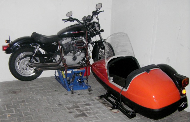

Sidecar...never owned one before but I do now. Not mounted...yet...just leaning on its side awaiting my love and attention. Velorex 562… 1970ish…retrofitted with tons of new stuff after being found in the dark corner of a garage somewhere in Eastern Europe. Needed mounting hardware and these guys helped me out ( http://www.mz-b.de/oldies/velorex/history/evelohist.htm)…its great living in Europe. Anyway, it’ll get mounted just as soon as I can make the 16” wheel conversion to the bike...start after the first of the year.

Don't forget to put some ballast in the boot or attached to the sidecar frame.
Your bike weighs about 600# wet without rider. The 562E sidecar weighs 154#.
For a nice stable rig add rider weight to the bike and weigh down the sidecar with ballast or passenger for around a 2/3 bike to 1/3 sidecar weight ratio.
If you want to fly the chair a lot go for a 75 to 25 Bike/Hack weight ratio.

Lonnie - Thanks for the tip...I had not read that. I was already planning on putting 2 x 45lb. olympic plates in the car to act as ballast. I'll use your 1/3ds, 2/3ds formula as a heuristic for the future. I am looking forward to testing out the rig. My primary concern is stability at speed. After seeing a lot of the European rigs, I'm convinced my next step is a leading link fork...we'll see if it's necessary.

Scout 99 - another option might be a raked triple tree. Pete Larson at Liberty Sidecar has them for big twins but for several years he manufactured a sidecar specifically for sportsters and he probably had something for them also. You might consider contacting him to see if such a component is available. If it is you will accomplish much the same as the leading link forks but at a considerable savings and your aesthetics will match the Harley look better.

Your present stock handle bars will offer hard steering. There are many 1" aftermarket bars available for cheap that will ease the steering. Altering the trail of the bike can always be done later should you decide to make a dedicated sidecar rig out of your Sporty. Raked triple trees or LL's are not condusive to riding the bike solo later if you so desire.
The Sporty/562E combo should be be quite stable at any speed if the bike and sidecar shocks are adequate. The 562E has a fairly soft shock and would be beeter served with one of heavier resistance to keep the rig from wallowing in the turns. The bike can also use better rear shocks and heavier viscosity fork oil to prevent front end dive.
If you use the lifting plates, be sure and place them behind the seat in the boot so you don't dip the sidecar nose in the sand when braking.

archon - I thought about increasing my rake, but already sunk some cash into a wide-glide tree set 2 years ago. My next step would definitely be a leading-link set-up...again, we'll see what I need when I start piloting this rig around Deutschland.
Lonnie - I have flat-track bars (it's a Roadster) that are wider than normal. Yeah, I thought about the placement of the ballast, but never thought of putting it in the rear of the boot. Was actually trying to find a way to mount the plates to the underside of the chair in a fashion so that I could add/remove as required. I only thought of Olympic plates because they are so cheap and have plenty of holes to use for mounting. Maybe the Germans have something available for ballast that I have yet to discover.
