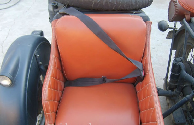

I found this one on a CJ site. I am not so sure how easy it is to get into the 3 point harness or even how securely it is actually installed. It is likely overkill though, but it was interesting to see in use.
The mouse trap flip of a Ural rig turning loose from the anchoring points is a concern in use of a seat belt on a Ural. I have never seen any pictures of a wreck in which this actually happened, but many owners do get concerned over the potential for the rear of the hack to flip over. Many Ural owners stap the tub down in the rear with a cable, but Dneprs come with a mount that already provides such a measure of safety. Again, in all the wreck photos I have ever seen of Urals, I have yet to have seen the mouse trap flip actually have happend.
It is really a personal choice to install the seat belt. I know the law in Texas does not address it in sidecar use or requirements. It is probably a "feel good" issue that the owner has to make a decision for himself, as there is really no standard testing to compare for seatbelts in a hack. I have heard the argument that the hack monkey would get smushed on the noggin in a wreck, but I have never seen anything remotely proving such. I believe there are many more statistics showing that riders or passengers flung from any vehicle will suffer more death and injuries than those who were not.
I believe that making the seatbelt safe during installation is even more important than putting one in. Anchoring points need to be just that and not some cobbled up or quickly-rigged attachment that looks good, but works poorly. The wrong use of the correct mounting bolts may seem unimportant, but when I used to work on antique cars, attend all the large car shows and hang with the hot rod crowd, daily, you would not believe how many poor seat belt set ups I viewed. The owners thought they were helping and their set up looked great. A simple low speed wreck would have proved them wrong in many cases.
I really think the idea of seat belts works well for children and in keeping them inside the hack.
I have seen some folks cobble together child seats and even booster seats for their hacks. I don't really think that is necessary or very workable when it comes to safety in a hack. However, it is up to the individual to determine how far they want to go and what they feel works for them.
I don't have seat belts installed in my hack at present. I generally ride with the dogs only, and they have leashes installed for their safety. The two leashes also hook together, so someone could put a kiddo into the hack and feel they were strapped in in some manner of speaking. All bets off in a wreck though.
It is probably the type of wreck that a sidecar gets involved in that is most important. It is unfortunate that there really isn't any clear testing or accurate statistics to look at.
Posted : June 25, 2008 3:06 am
