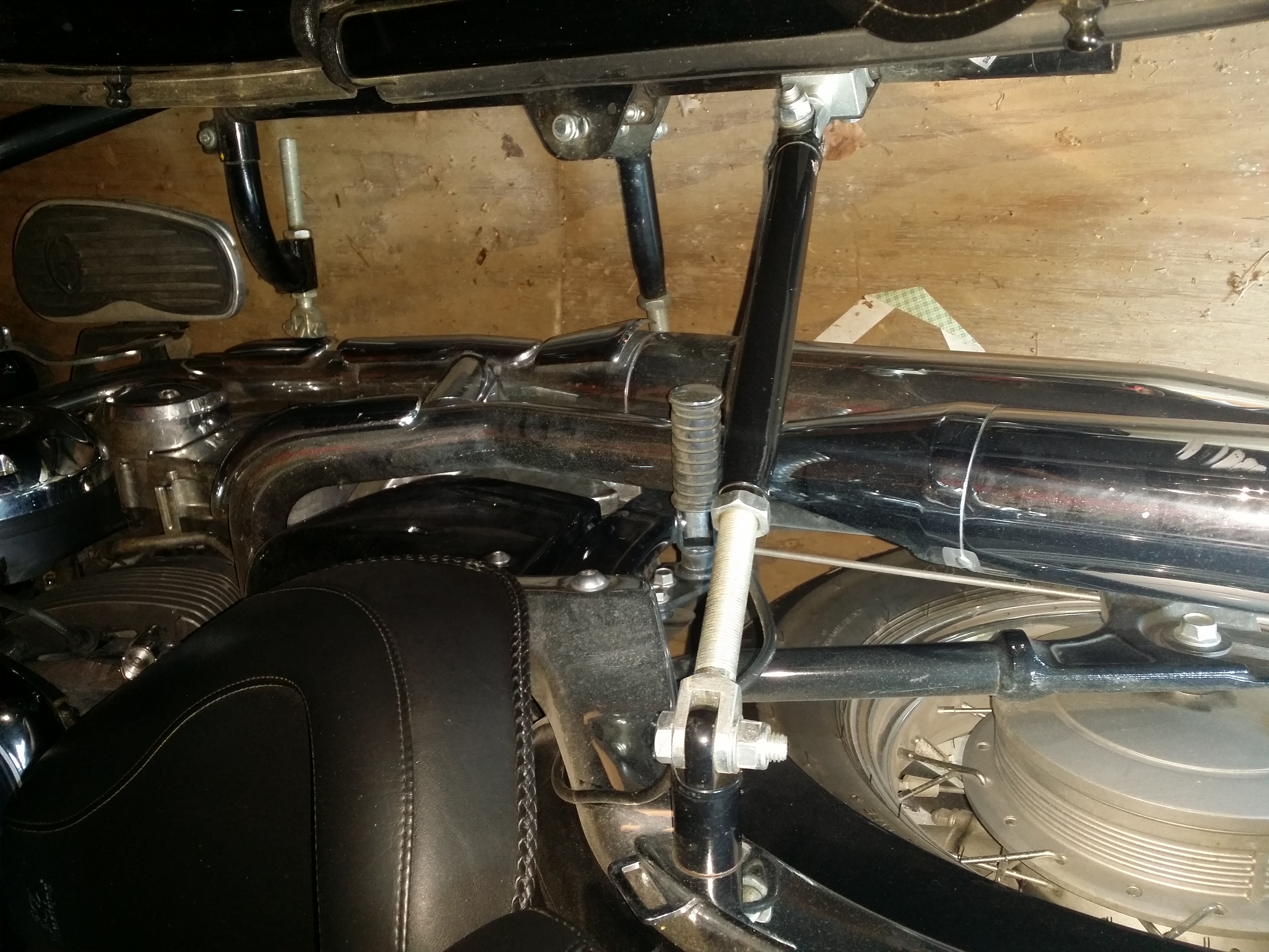

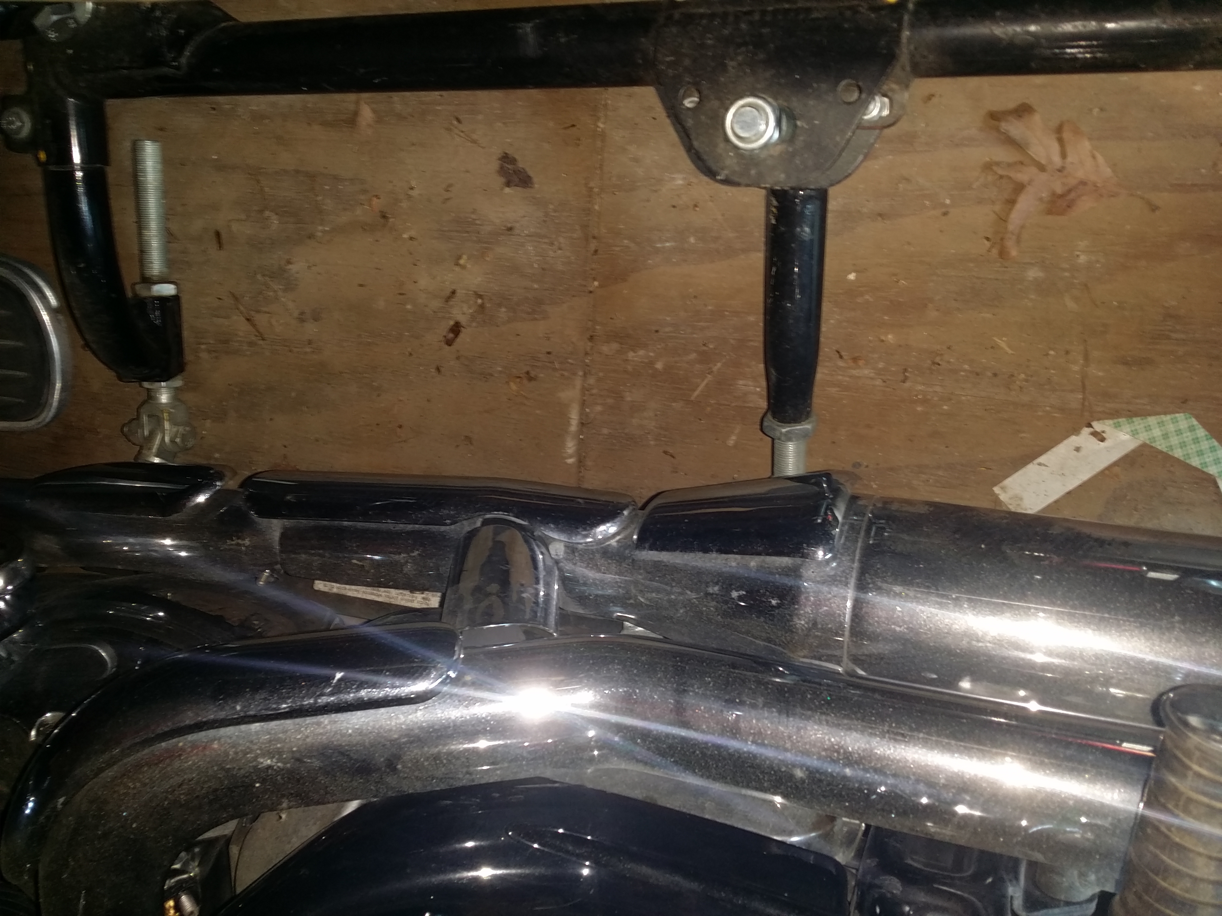

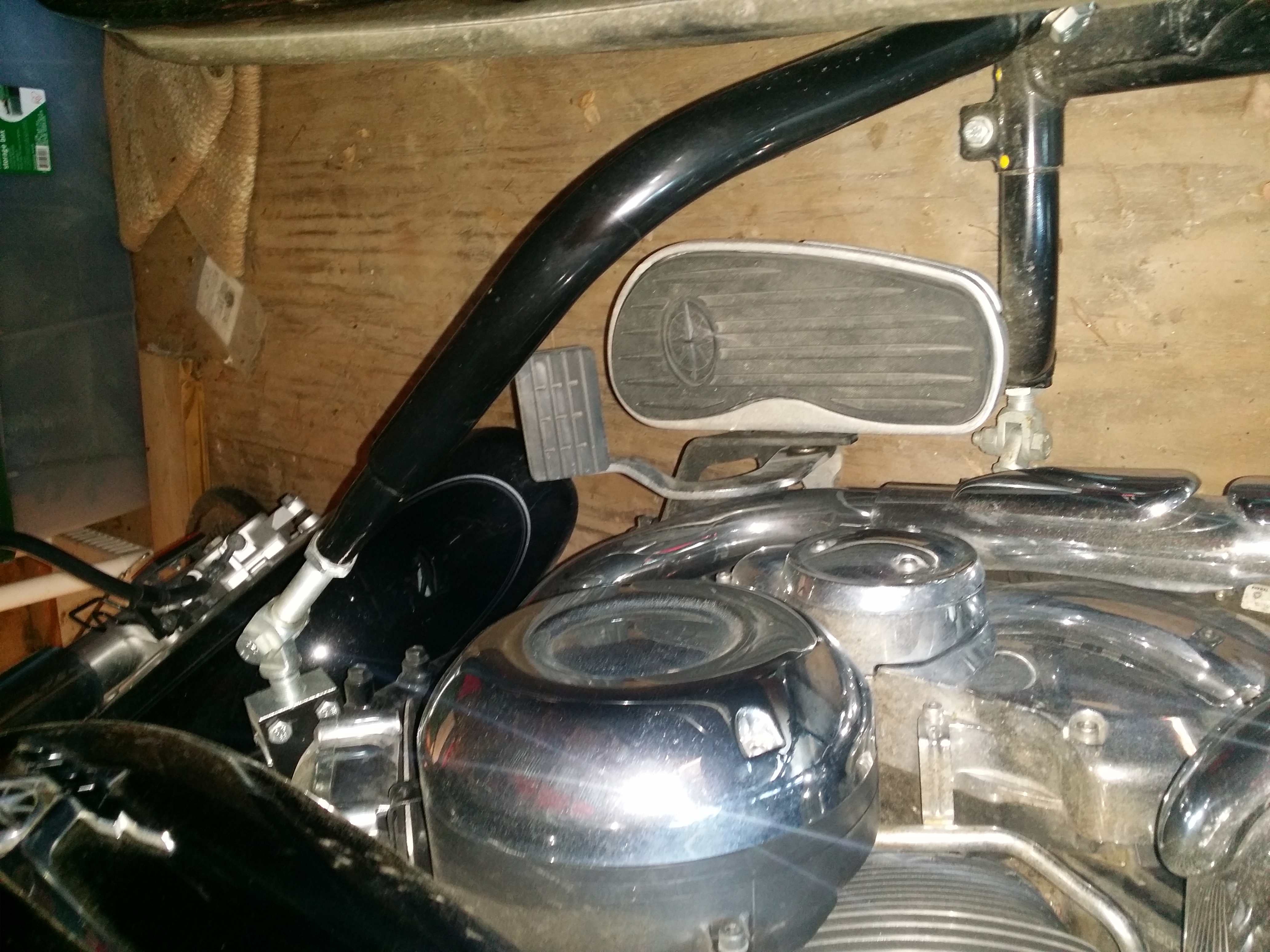

(@pappyxmas)
Posts: 21
Here's the mounts. Please forgive how dirty everything is, I live down a dirt road and even sitting parked in it's garage it gets covered with dust and this time of year, a thick yellow coat of pine pollen. Keeping it clean is pretty much out of the question.
Posted : June 15, 2014 1:29 pm
I always attach the Velorex rear sliding mounts this way to reduce the tendency to slip or twist. Eliminating the 90 degree angle and adding the resistance of the eyebolt, when placed in this position.
I don't know why the editor of the (US) Velorex handbook used an illustration with the angular installation in the mounting instructions.
The more angles incorporated just increase the tendency for slippage since this is a paint to paint connection, not metal to metal.
NWSC
Posted : June 16, 2014 5:50 am
