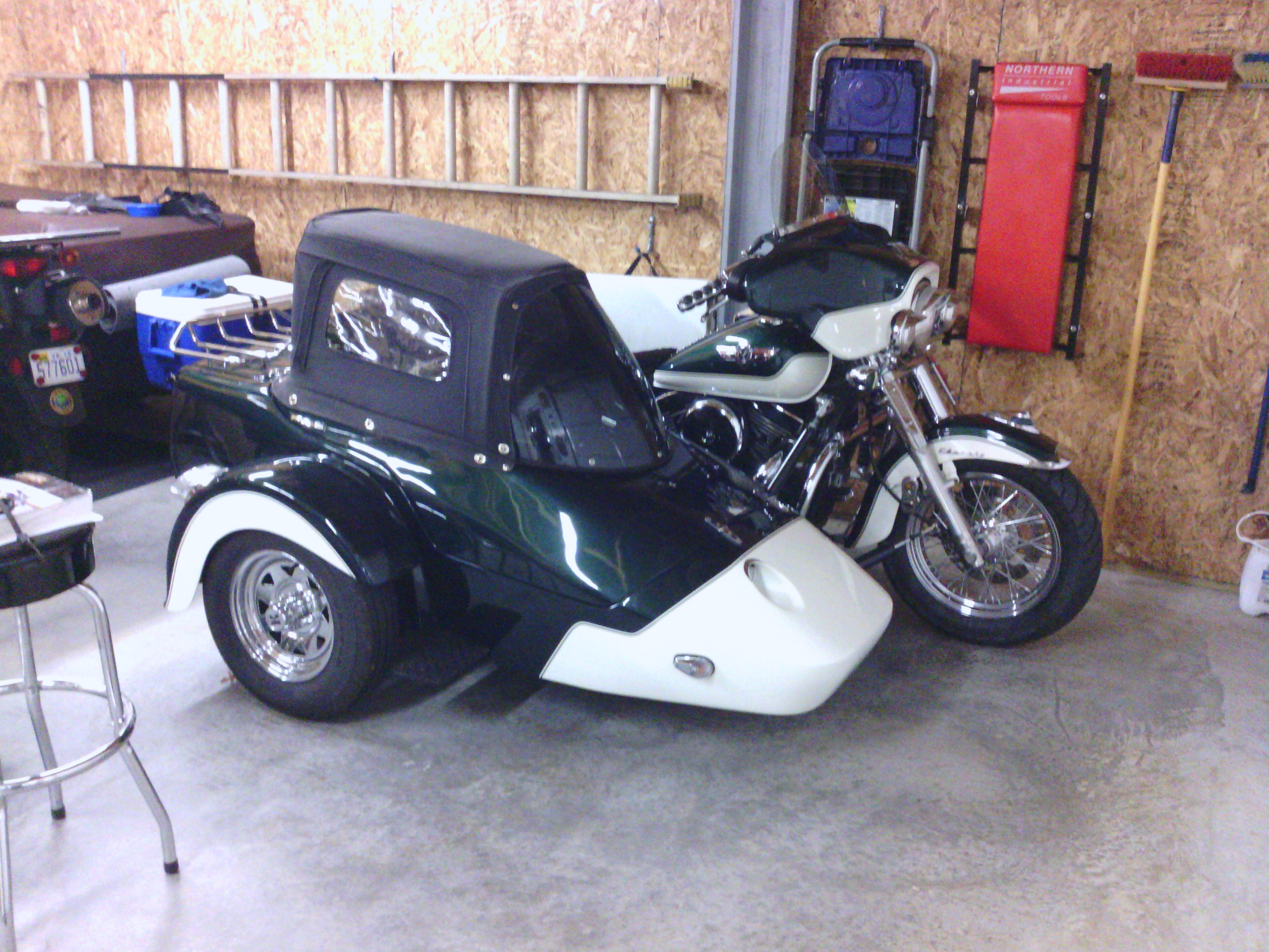

I have a couple of rigs, one o which is a Kaw 1500 Vulcan/Hannigan Classic. I have put about 40,000 on the rig and have been very pleased. I have thought several times about how nice it would be if it were the newer 1700 with a little more power since I live in the mountains of Va and pull a camper some. It has been very reliable though. I did install an auxiliary gas tank and an automotive tire on the rear. I run a rear tire on the front turned backwards. It would be easier if I had installed a steering mod for the twisties, but it has a good frame for mounting the chair. Best of luck with the search.
Bill D.

Pic of rig

Pic of rig

Thanks for the help! Jay I have been keeping an eye on the auto tire thing, 16, 17 and 18 seem to be doable I managed to find and fit a 16 on my sportster! I will mount the car with a subframe to some extent!
Jay, with your experience which line makes a better tug for mounting? Have you done more of one than the other? Do you like one frame more?
draperg, great looking rig and love to hear that mileage! That is what we want! We don't change things, just because or that would be nice! I want a good LONG term rig! If I wear it out that is fine but I don't want it to fall apart on me!
