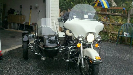

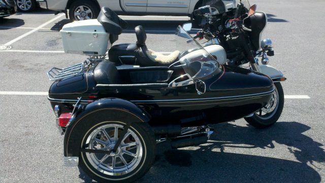

I worked this week on getting the bike ready and attaching the sidecar. Here are some pics.
Many thanks to gnm109 who gave valuable advice to add a 12" vertical extension to the brake line T for the sidecar connection. I went to NAPA and got the parts I needed.
Tony T
Reisterstown, MD
days: http://www.tontodonato.com
Posted : September 12, 2010 3:13 pm

Awww shucks, 'twarn't nuthn'. Happy to help. Good luck on your installation. 🙂
