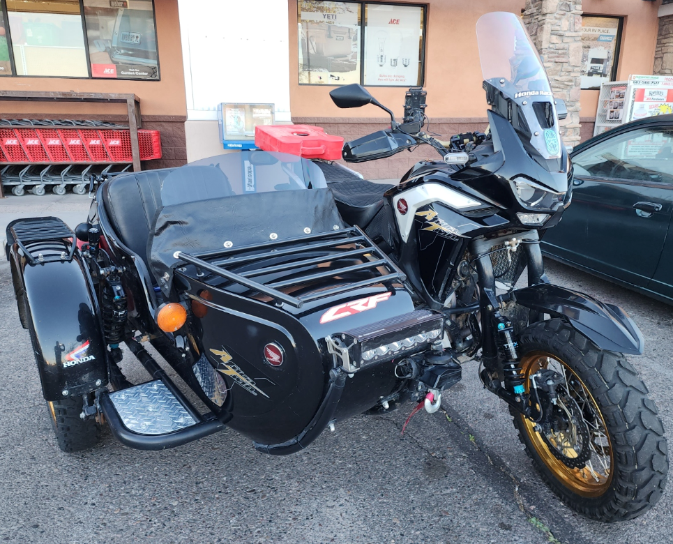

I am running a Mitas E07+ Dakar on the front, at the moment, an E07 Dakar on the hack and pusher wheels.
I like the traction characteristics on the plus series almost enough to put up with the wear on the rear.  However, their recent lack of availability anywhere I look for the 150/18 size, combined with a really good price on the "not plus" series at an ebay seller, means I will be running the not plus, Dakar series for a while, at least.
I hope for the double life of the last plus series rear tire that you mention, but am getting better at changing them, at least!
The concept of a street rig crosses my mind from time to time... a late Gen VMax would make for a lot of road fun! (With mobile gas station attached!)

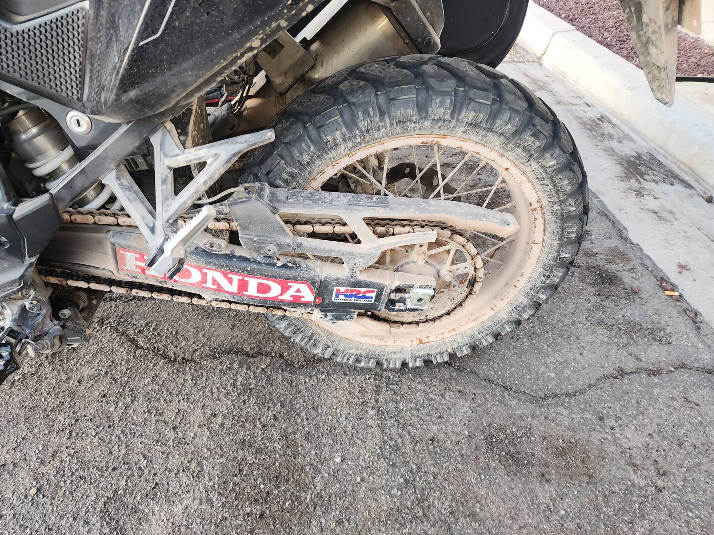

Not "plus"
20240509 021956

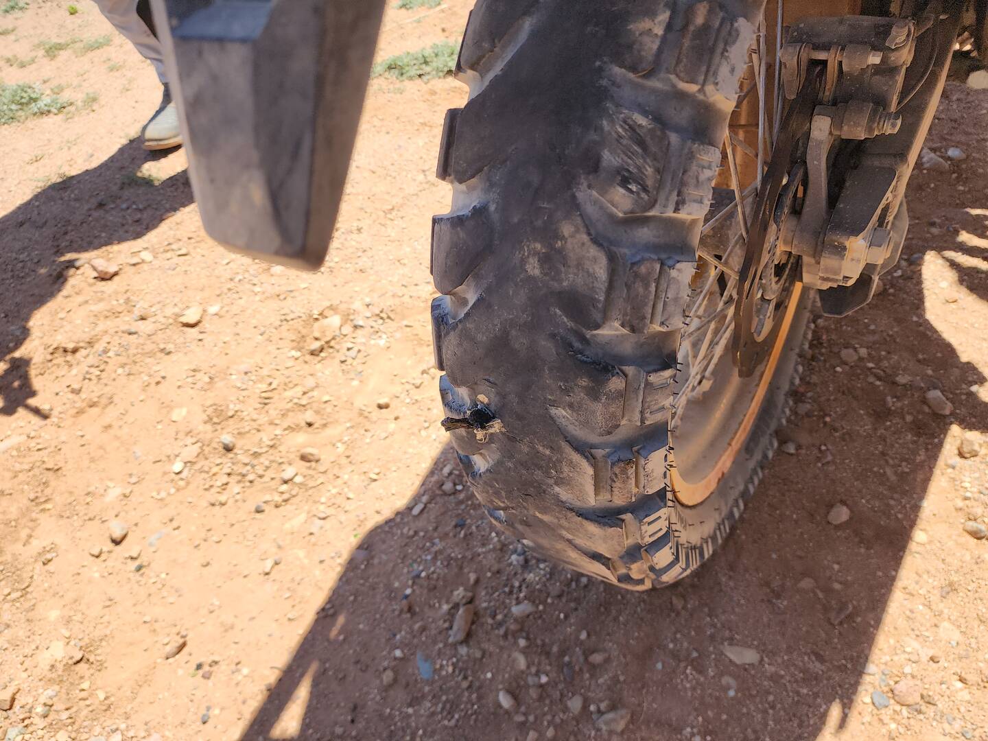

Plus
20240505 105350

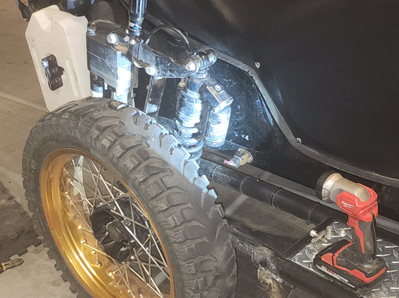

20240218 180234
Not plus hack wheel at 26,000 miles: Probably will leave it until I see cords!

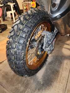

Plus mounted backwards on front, maybe 8,000 miles on it:

Ben Franklin, generally speaking, toe-in scrub wear is experienced solely by the sidecar tire.  And since the sidecar tire is not heavily loaded during half your turns, not used for hard braking, not used for throttling up etc. it takes a long time to notice any unusual wear on the sidecar tire.  In fact, I might go so far as to say that MOST wear on the sidecar tire is caused by scrub, and so it's pretty difficult to draw a line between unusual scrub wear and expected scrub wear.
In my opinion, then, in your case, your rear tire wear is being caused by PEBSAT.
Which is an issue for many of us.
PEBSAT  -- Problem Exists Between Saddle And Throttle
