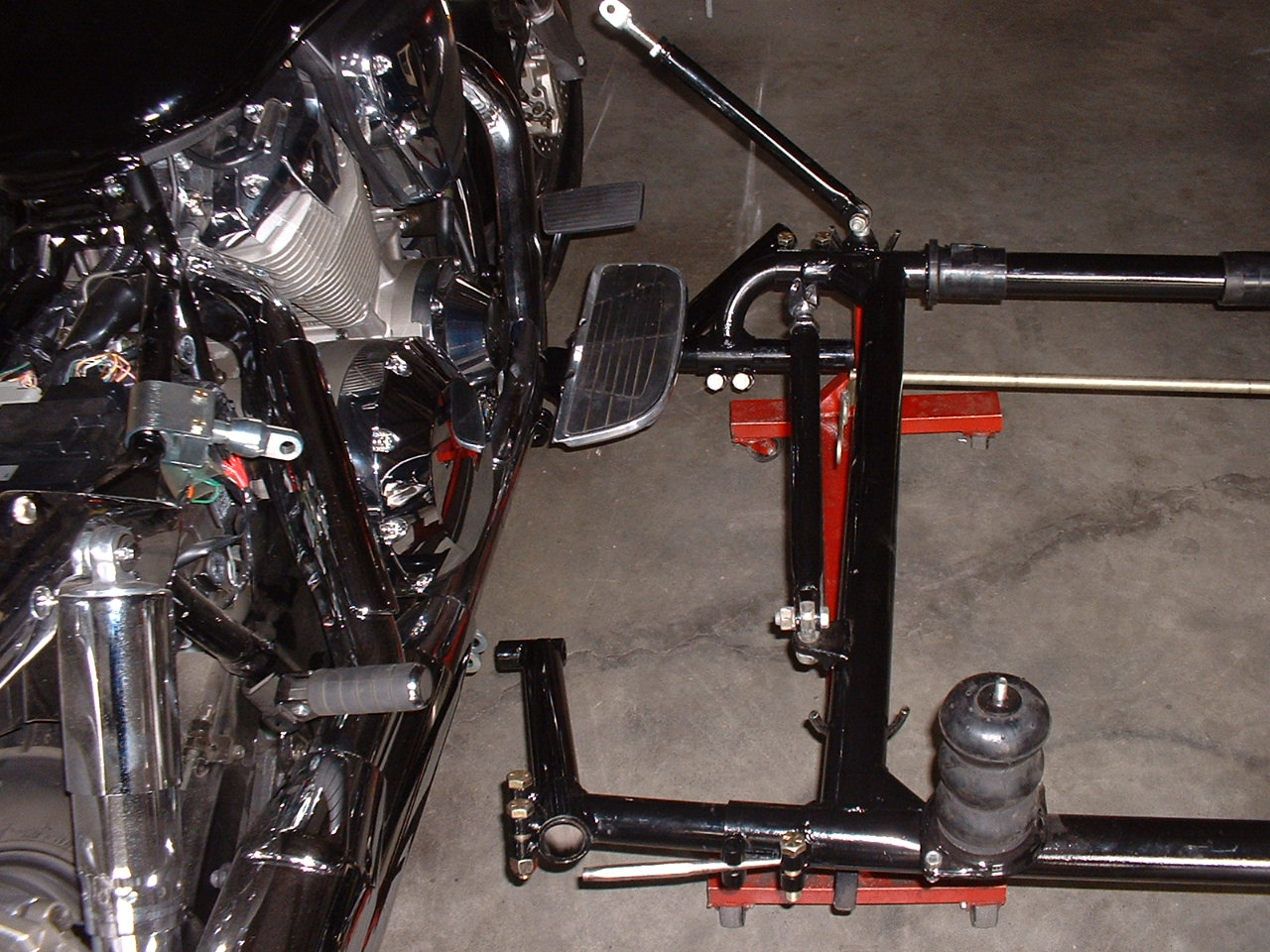

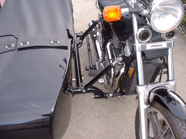

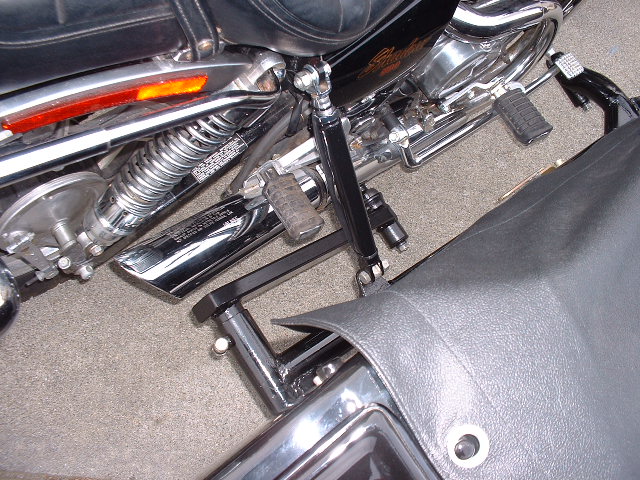

The very short lower frame could use some sub-framing to accomodate the looong Dnepr frame well for a rigid mounting.
Commercial adjustable mounts are available for the Dnepr/URAL/CJ's or if you are (or have) a fabricator, the ball mounts also work well with a few modifications.
The front mount can be cut and rotated to move the car farther back and help accomodate the differences in frame heighths.
The rear sidecar mount can also be moved farther forward if needed.

FWIW, I had a Dauntless subframe on my Valkyrie. It was built to last. I would buy another from them.
