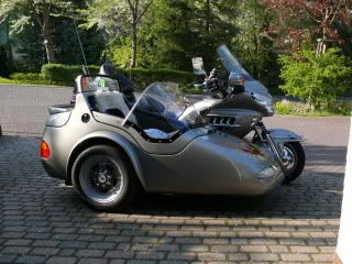

what a shame with your tires. I can`t just believe what you are telling. What sort and size of tire are you using on your sidecar ? 3500 miles is just nothing. As far as I can remember, no one of my friends who are also riding different types of HD - rigs have that lousy mileage on sidecar tires.
On my rig the tires have a lifetime average of 30-35.000 km (which is equals 18 - 22000 miles).
But to be honest, I have mounted only car tires:
14" front wheel with a Michelin 165/65R14 tire
15” rear wheel with a Michelin 185/60R15 tire
and the sidecar has also
14" wheel with a Michelin 165/65R tire.
Have a look at the attached pictures and I wish you at least good luck to find better and long life tires for your sidecar.

Spring 2009 - 3
Spring 2009 - 2
