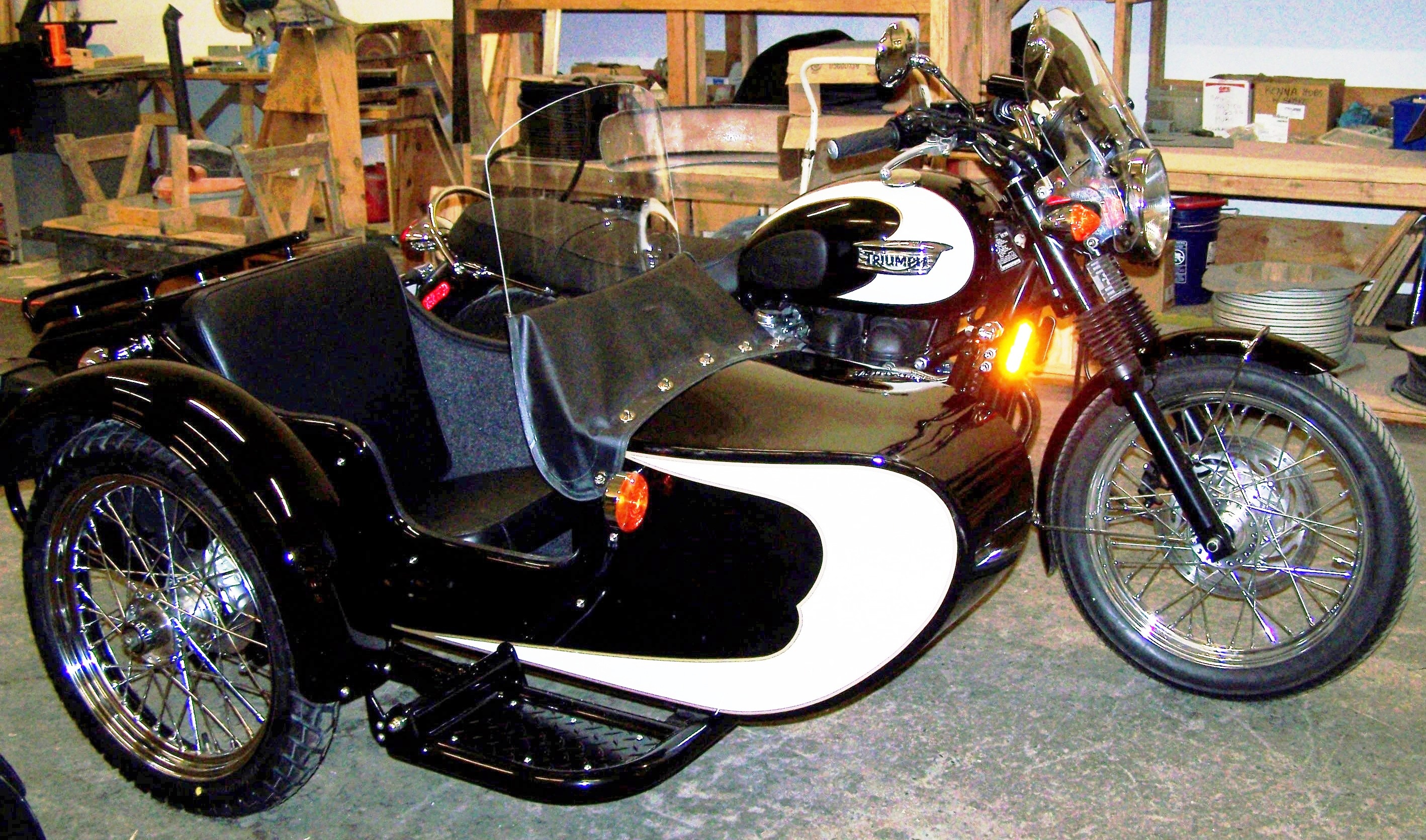

And here is a pic of a Standard mounted on a Bonneville - Pretty ain't it? (Unfortunately, I understand this combination was recently separated):

Lee, I think your rig is the first Sportster/Ranger setup that I saw which got me interested in the Texas sidecars, the lines just sort of mesh with the Sportster and make for a good looking setup (as well as with the Bonnie). Thanks for the info and I'll definitely be using your solution for the dogs as a starting point if I go this route. Out of curiosity, did you ever consider adding a lock to the back of the body to lock the seat down or look into fabricating a locking trunk any other way?
In regards to the Bonnie/Standard rig you posted, I remember drooling over that one when it was up for sale a couple of years ago but I hadn't really decided if a sidecar was the direction I wanted to go at the time.
