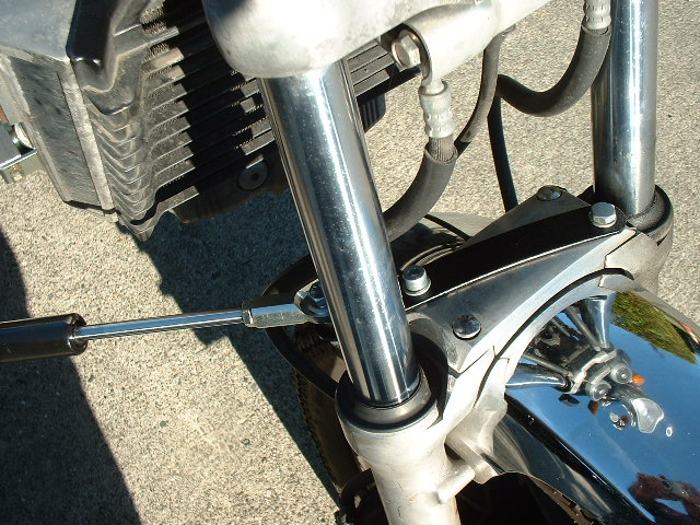

You should be able to get the head shake managable by: Snugging down the steering head bearings, rebalancing the front wheel, checking rear swing arm bearings for play, replacing the rear shocks with some that really work, installing heavier fork oil for rebound stability.
A small amount of nose wiggle is inherent with this bike/sidecar combo unless the trail has been altered. Usually at a low speed when on the throttle or decellerating.
If still uncontrollable a VW damper can be used placed as shown in the photo. The bushing end can be attached to the upper s/c strut.

Very clever attachment on the fork brace.
