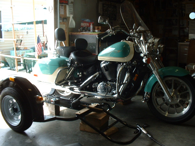

I would imagine your 1998 Honda would look something like this: (Attached). This 562 has been equipped with our HD suspension upgrade to handle the heavier bike but the mounting remains the same as yours' would be.
You will need the front upper strut either curved or reshaped like this one for brake control clearance. The rest of the attachment kit can be used as is.
Note how I set the lower rear mount in a straight line instead of the goofy way the Velorex Handbook has it mounted. My method keeps it from slipping and rotating on the sidecar frame.
You can place up to 100# of soft ballast low and to the rear (trunk) of the sidecar till you get used to the handling. Lead shot bags work well at 25# each. Two fabric shopping tote bags with 50# of sand are easy to handle and much cheaper. I recommend soft ballast so it will not damage the fiberglass body if it shifts. After the training curve ballast as needed for your driving style.
A sidecar body paints the same as an automobile body. You should be able to do much better price wise on the painting if you are
able to remove the body, fender and appurtenances you yourself and take just those two parts to the painter. With the simulated leather finish below the waist moulding the painting is much easier. Few paint over that area and it handles rock chips much better than paint.

Thanks for the responses...very helpful. Lonnie, the attached pictures of VERY helpful. Thank you. The Ace Tourer in the attachment is identical(color inluded) to mine. As I get closer to mounting the rig, I'll have more questions.
Thanks again!
Dave
