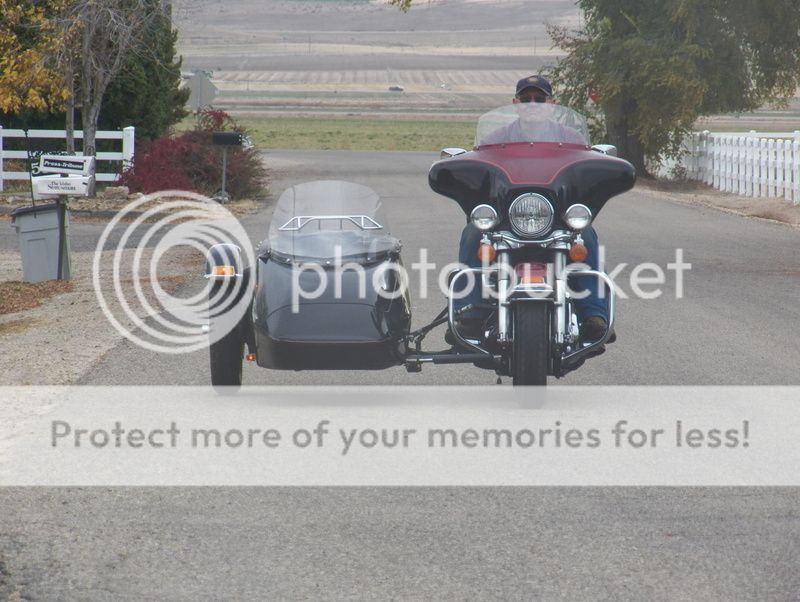

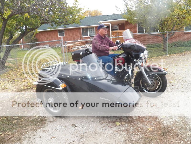

Pics - - took my first ride and it wobbled - added some toe in and it's great! It's my first ride so I'm in a steep learning curve here but what a HOOT!!

I was just enjoying the pictures again and noticed the low mount steering damper. That's interesting. Only ones I've seen before are mounted up top from frame to forks.
Posted : November 3, 2012 1:13 pm
Posts: 616
He says he'll have Lonnie look at it. I'm sure Lonnie can get that stabilizer mounted up high on the fixed part of the fork. Looks like either the engine guard or the lower front strut are possible places to anchor the other end.
Posted : November 3, 2012 7:43 pm
The stabilizer is mounted where my brother had it. He rode it for over a year with no problems so I left it where it was. Is this a potential problem?
And yeah I'll get by Lonnies at some point in time so he'll likely have some advice about it also.
Posted : November 4, 2012 2:25 am
Steve N - 11/4/2012 7:25 AM The stabilizer is mounted where my brother had it. He rode it for over a year with no problems so I left it where it was. Is this a potential problem? And yeah I'll get by Lonnies at some point in time so he'll likely have some advice about it also.
My 86 Aspencade/HitchHiker rig had the stabilizer mounted low. One of the caliper mounting bolts was replaced with a heim joint that threaded into the caliper mount.
That was in the early 90's. The sentiment was that the wobble doesn't start at the neck, it starts at the wheel. Never had a problem with it there. It's the only rig I've owned that had one, so I have no experience with them mounted elsewhere.
