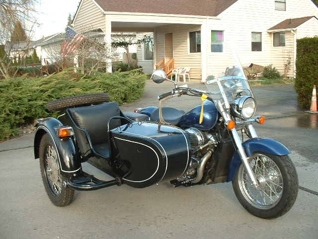

Attached are a couple of options for 750 Shadows we have set up here.
A big rake isn't enough for easy steering it's the shorter trail that makes it happen.

That's the Velorex 563 Tour. A classic styled roadster. It's our best seller and the best bang for your buck as it comes with everything included except the bike. No long list of optional extra cost extras.

I have a hannigan conte on my bike. I have a 97shadow ace 1100cc. I am still working out the bugs but I am beginning to be happier with it daily!
A side car will reduce top speed by up to 20%. It will affect your gas mileage somewhat. The steering has to be left stock if you intend to put the car on and off regularly. You will notice the steering to be heavy with stock steering but many people have it stock including myself and it's not too bad!. Larger bikes need a gear reduction of about 10% where small bike need up to 25% gear reduction. Read up on these things in the older threads and in technical issues to give yourself a better understanding of what's involved. Lonnie is one of the most helpful here. He won't steer you wrong 😉
