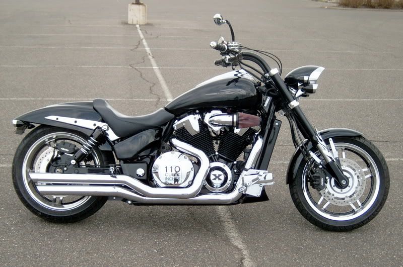

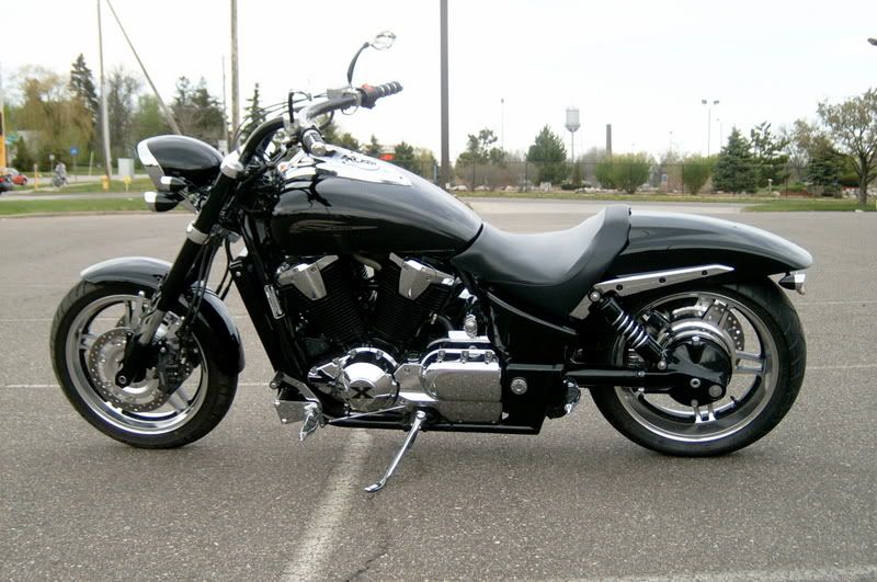

Couple pictures of my VTX
Photobucket
Photobucket

VTX Honda 1300 or 1800 Cruisers.
Here's a couple of my 1800 conversions. One with a Kenna & one with a URAL.

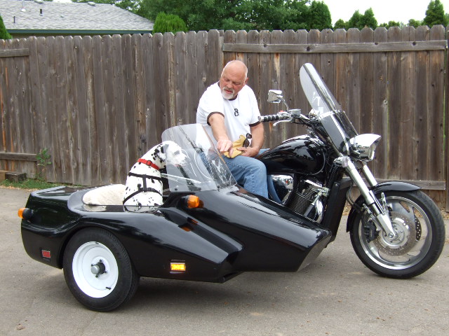

Hi,I have a Daytona 2+2 attached to my 03' VTX1300 I had a tonneau cover made that I can flip the sides up inside, lower profile which I prefer, rarely do I put the rag top on. my grand daughters have a blast riding with me

Linda, a little off topic, but...I noticed in the pic you have your foot down..is this to keep the bike from falling? :o)
yes, sorry for jumping into someones thread here...lol Bob, I think I was about to get off.... good answer? I'll bet I was using the left foot (reverse gear)to get parked... ya that was it. lol
